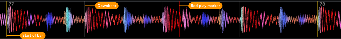

Scrolling waveform​
Scrolling waveform
The scrolling waveform provides a real-time, zoomed-in view of the track as it plays. It updates continuously and responds instantly to actions like scratching, scrubbing, or jumping to a cue point.
Each bar is numbered at the start, and downbeats are marked with a solid white line in the beatgrid—helping you visually follow the rhythm and stay in sync while mixing.
The vertical red play marker moves across the waveform to show the current playback position, making it easy to align beats, monitor transitions, or anticipate upcoming elements in the track.
