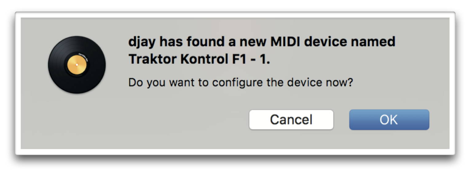

- An automatic pop-up message will appear in djay alerting you that the device has been found, and asking if you'd like to configure the device now. Click "OK". If you'd like to create a mapping later, you can also access the mapping window by selecting the controller from the "MIDI" menu in the top menu bar.
- The MIDI configuration window for the controller will open, displaying a blank mapping screen.

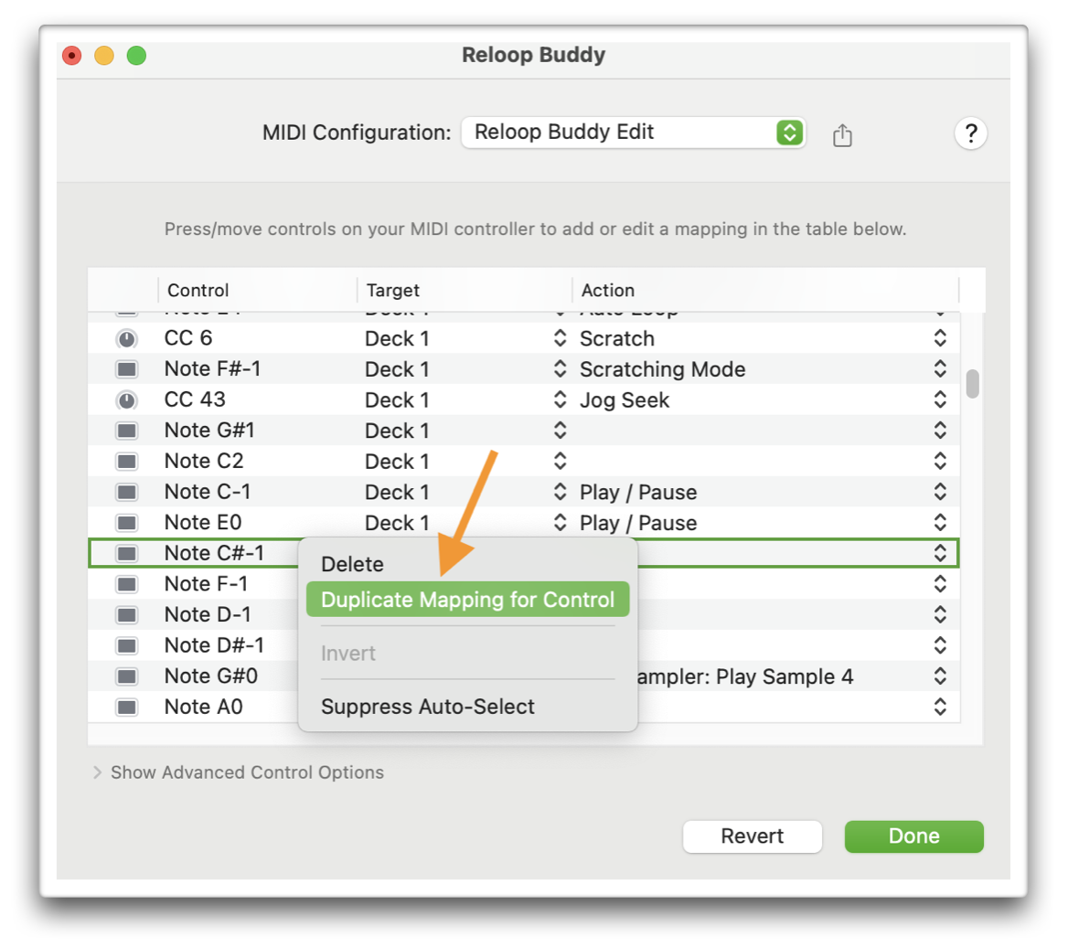

Adding multiple actions for a control
You can also make a single control perform multiple actions when activated: simply control-click (right-click) the mapping entry and select "Duplicate Mapping for Control" from the menu to create another mapping entry for the same control, which you can again map to the desired target/action.

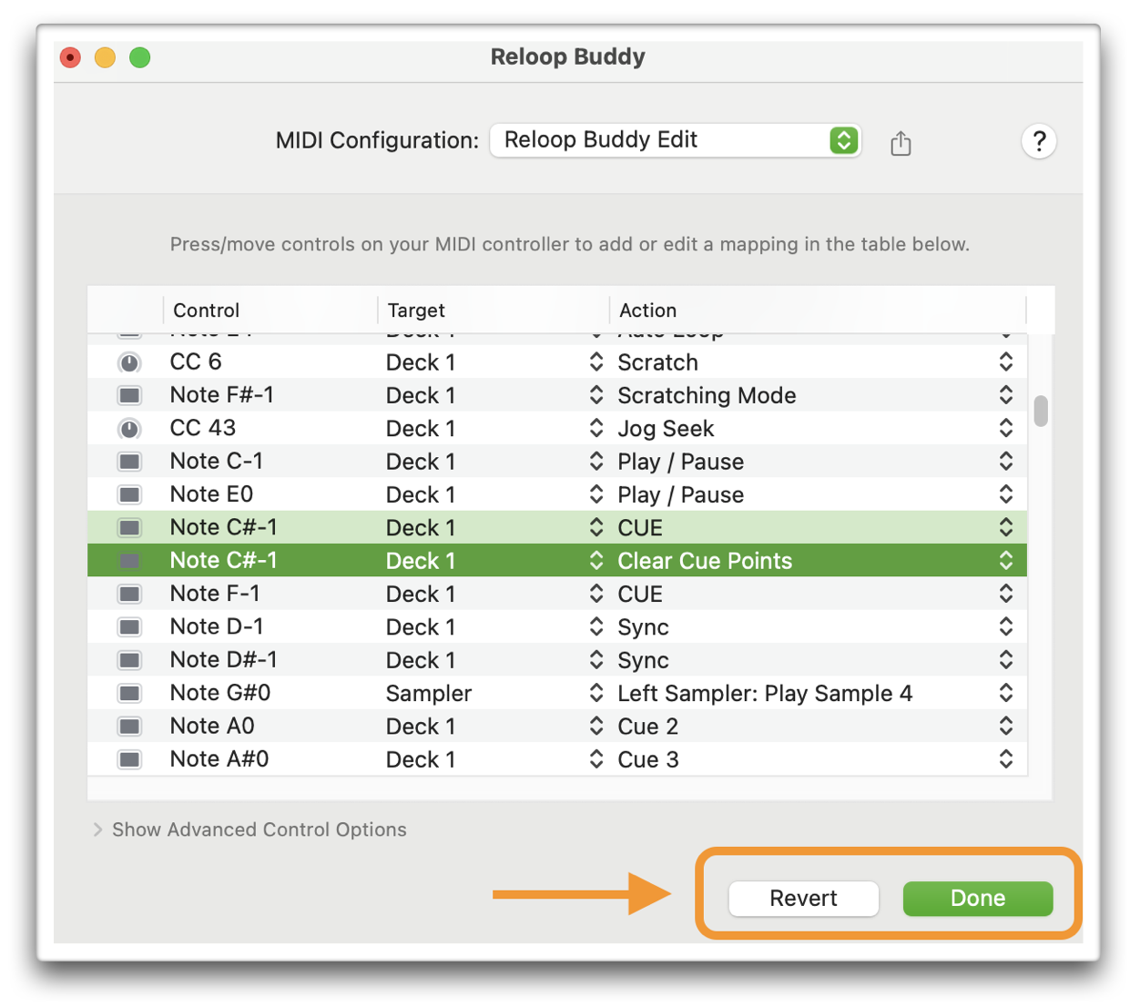

Saving or reverting the configuration
Select the Done button to save your custom MIDI configuration in djay Pro AI. Select the Revert button to revert back to the last saved configuration, or to an empty list of mappings if the configuration was not saved before.

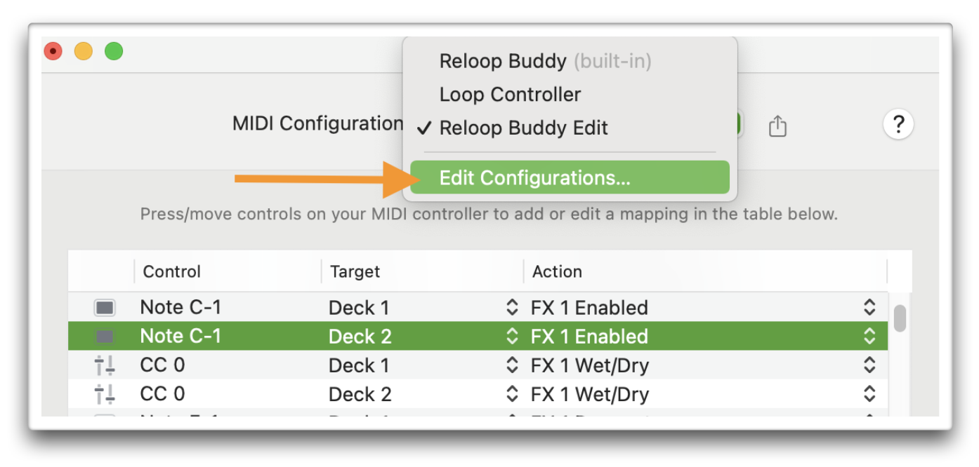

Using multiple configurations
djay Pro supports having multiple alternate MIDI configurations for a controller. For example, if you have a MIDI controller with multiple "trigger" buttons, you could have one configuration where the buttons are mapped to trigger samples, and another configuration mapped to control audio FX or loops.

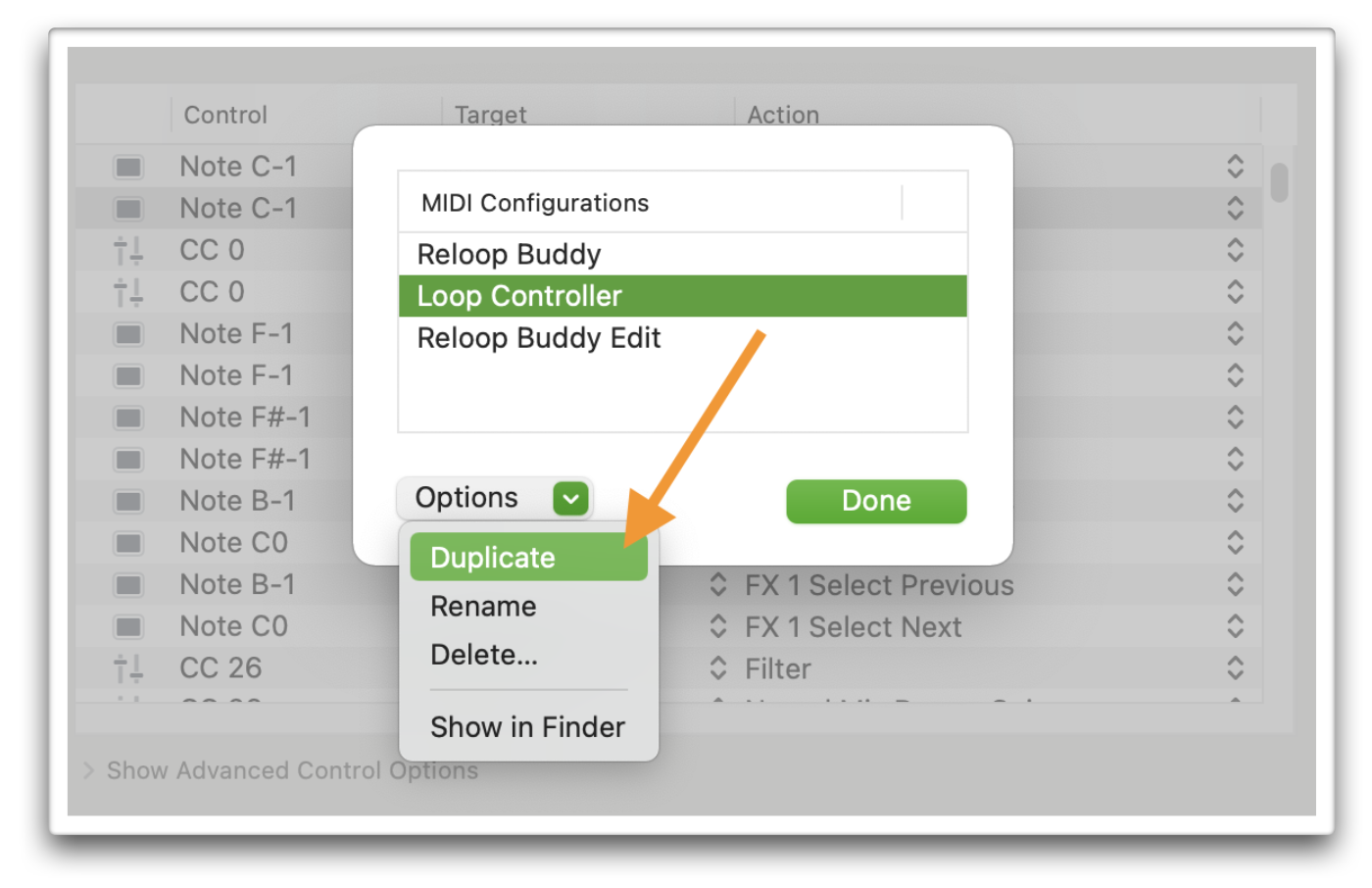

To create an alternate configuration:
- Select "Edit Configurations..." from the "MIDI Configuration" menu at the top of the MIDI configuration window.
- Select your current configuration from the list.
- Select "Duplicate" from the "Options" menu.
- Rename the new configuration by double-clicking the name in the list (optionally).
To use multiple available configurations:
Simply select the desired configuration from the "MIDI Configuration" menu at the top of the MIDI configuration window, and djay Pro will allow you to easily switch between these as needed.

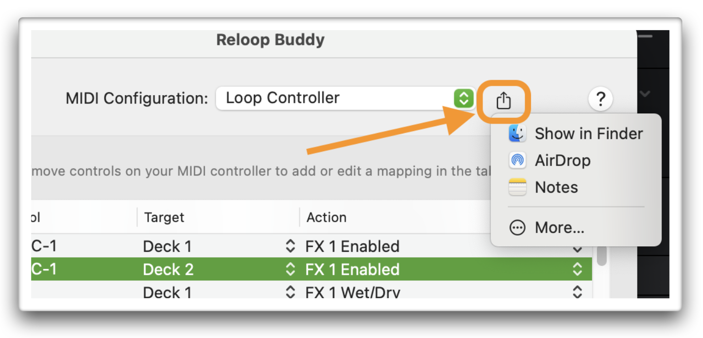

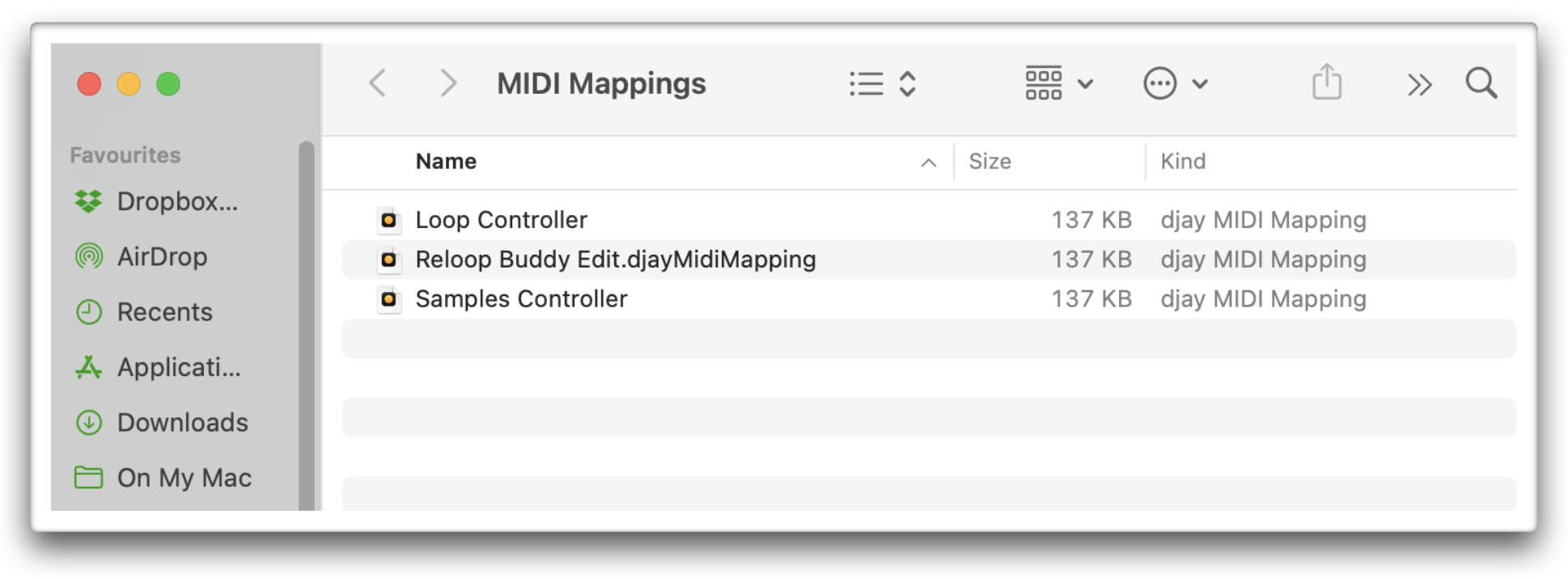

Sharing MIDI mappings

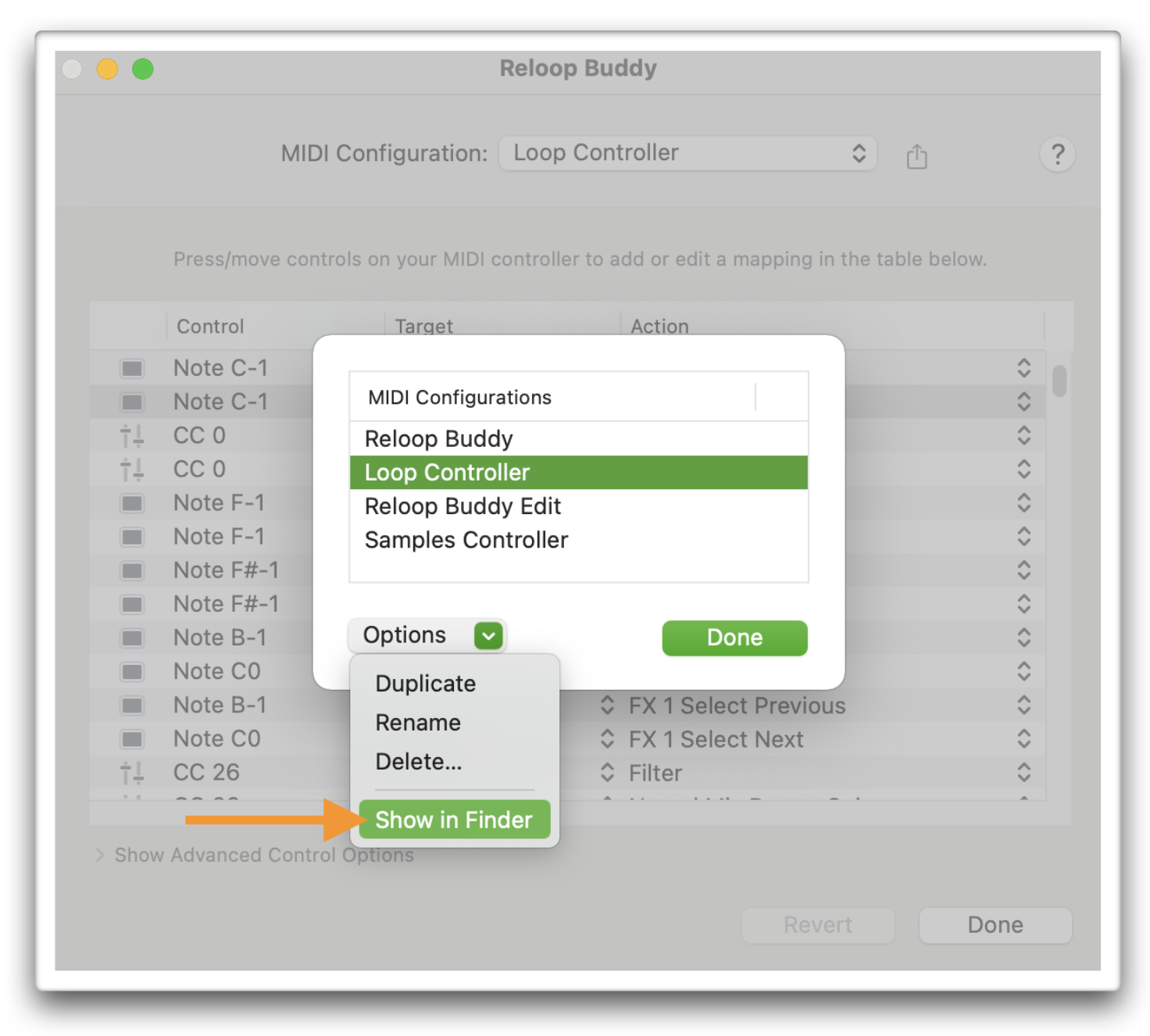

Use the macOS Share Menu icon in the MIDI configuration window to share your mappings via the available options, such as directly from the folder where they are saved, or via AirDrop.
From the drop-down menu, select "Show in Finder" to quickly open the folder where the mappings are saved.
Note: You can also access the "Show in Finder" option when you select "Edit Configurations..." -> select the name of the mapping you'd like to find -> select "Options" -> select "Show in Finder".
From the MIDI Mappings folder, you can, for example, send the mapping file via email or save it on a USB drive.
To install a MIDI mapping file for use in djay, simply double-click the file in the Finder folder.
