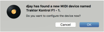

  2. Connect your MIDI controller to your computer via USB and power it on. A pop-up will appear asking if you want to configure the device. Click OK.
    MIDI controller popup

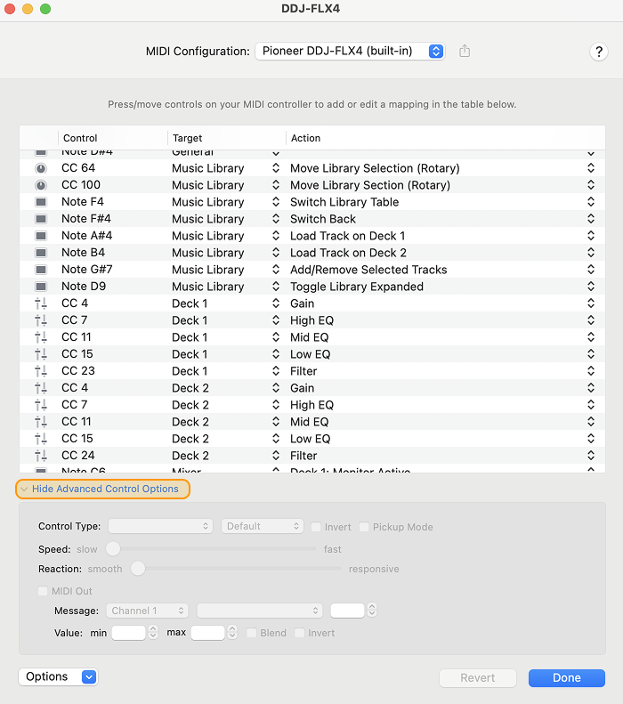

The Advanced Options panel allows you to fine-tune how your MIDI controls behave in djay Pro. These settings are useful if a mapped control doesn’t respond as expected, or if you want to customize how your hardware feels.
Mapping MIDI advanced controls
  • Control type
    Choose the type of physical control you're mapping:
    • Button
    • Fader/Knob
    • Rotary (01h/7Fh)
    • Rotary (3Fh/41h)
    • Rotary (absolute)
    The different Rotary control types are for endless rotary controls (encoders) like jog wheels or music library controls. The easiest way to find the right option is to test the control with each option.
  • Invert
    Some MIDI controllers send inverted signals for sliders and knobs, causing them to move in the opposite direction in djay Pro. Enabling Invert reverses the signal so the control responds as expected. This is useful if a knob or fader behaves in the opposite way to what you intended.
  • Pickup mode
    Prevents sudden jumps when using shared controls (like a single fader for multiple decks). djay Pro detects when your MIDI controller is out of sync with the on-screen control and temporarily disables it until you bring them back into alignment. Especially useful for tempo sliders, which can shift when Sync is enabled.
  • Button mode
    Defines how a button behaves:
    • Default: Performs the action when pressed.
    • Toggle: Alternates between two states with each press.
    • Hold: Only active while the button is held down.
  • Speed
    Adjusts how fast the control responds to movement, especially useful for endless encoders (e.g., scrolling through the library).
  • Reaction Controls how quickly jog wheels respond:
    • Smooth settings feel more gradual.
    • Responsive settings feel more immediate and tight.
  • MIDI Out
    Enables djay Pro to send feedback signals to your controller—like lighting up pads or toggles. This works with hardware that supports LED or visual feedback.
    For most controllers, simply enabling the MIDI Out checkbox will allow button LEDs to work correctly. For others, you may need to manually select the correct MIDI channel, message type (CC or Note on/off), and control number that corresponds to the button you're mapping.
  • Channel
    Sets the MIDI channel the signal is sent on (1–16). Match this with your hardware settings if needed.
  • Type
    Choose between:
    • Note On/Off: For buttons or pads.
    • Control Change (CC): For knobs, faders, and continuous controls.
  • Control
    Specifies which control receives outgoing MIDI messages. This can differ from the mapped control, allowing for more complex feedback setups.
  • Value
    Set the minimum and maximum values for outgoing MIDI signals (0–127).
    • Min controls the LED color when the button is not engaged.
    • Max controls the LED color when the button is engaged.
You can also adjust the output behavior with these options:
  • Blend: Smooths the transition between values.
  • Invert: Reverses the MIDI output signal.
