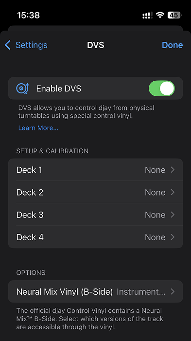

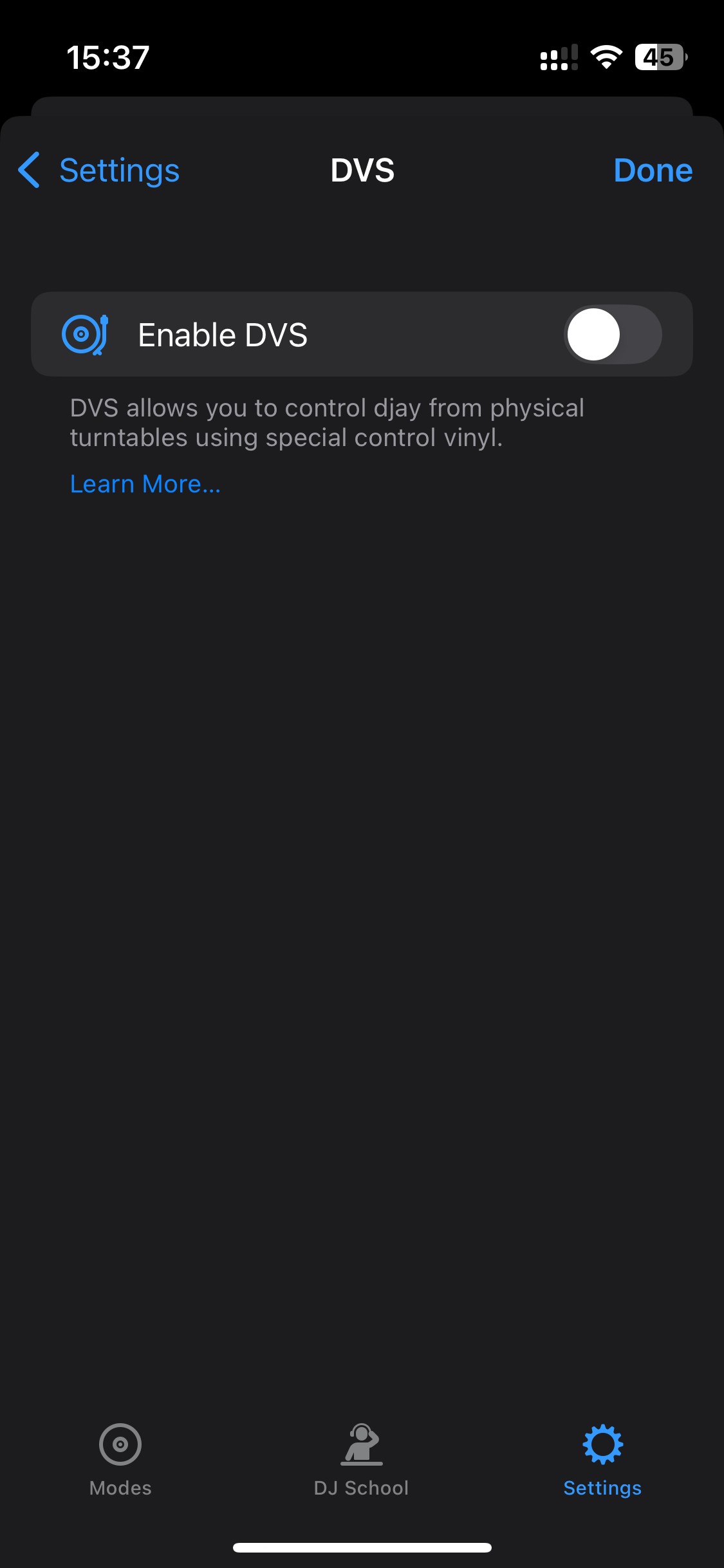

Enable DVS​
Activates DVS in djay and adds DVS controls to the interface.
Keep this option disabled unless you are using official timecode vinyl.

Setup & Calibration​
Assign the audio device and stereo input channels for your turntables. You can also switch between phono and line level input, depending on your hardware.
Many mixers and controllers include a hardware switch for phono/line selection.
Calibration: Shows real-time DVS calibration scopes and provides calibration buttons for each deck. Use this to check signal quality and correct any input alignment issues.

Options​
Neural Mix Vinyl (B-Side): Toggle between Neural Mix™ modes on the B-side of the timecode vinyl:
  • Instrumental / Acappella
  • Percussive / Tonal
This allows you to isolate or emphasize parts of the track while mixing live with vinyl.

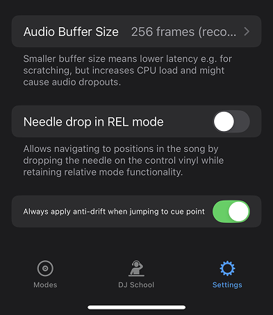

  • Audio buffer size: Sets the audio buffer size between djay and your system’s processor:
    • Choose between 64 / 128 / 256 frames
    • Lower buffer = better responsiveness
    • Higher buffer = more system stability
Use lower settings for scratch precision. Higher settings make playback more stable on older hardware.
  • Needle drop in REL mode: When enabled, dropping the needle will jump to the correct point in the track while using relative timecode mode.
  • Always apply anti-drift when jumping to cue point: When active, the software compensates for minor needle jumps or degraded timecode signals.
    • Enabled: Track location sticks to the vinyl position—ideal for scratch-heavy sets.
    • Disabled: Cue point jumps behave more predictably for routines like cue juggling.
Anti-drift works automatically in most cases. However, you can toggle it based on your style. Enable for scratch routines. Disable for precise cue juggling.
