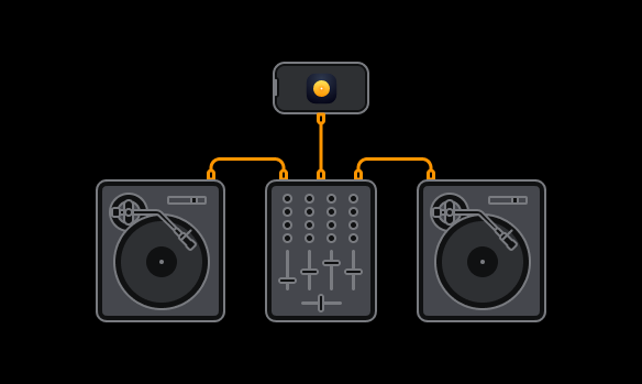

How to connect your gear​
Properly hooking up your setup is essential for a clean, stable timecode signal and reliable DVS performance.
  1. Confirm whether your turntables can switch between line and phono output.
  2. Ensure they are both switched to the same setting.
  3. If using phono, attach each turntable’s ground wire to the mixer’s ground terminal.
  4. Connect the RCA cables to the corresponding line/phono inputs, making sure left and right channels are correctly matched.
To check that the timecode signal is being sent correctly, play the timecode record while your mixer input is set to line/phono. You should hear a strong, high-pitched tone from the speakers (and from the needle itself). This tone confirms the turntable is generating the proper control signal.

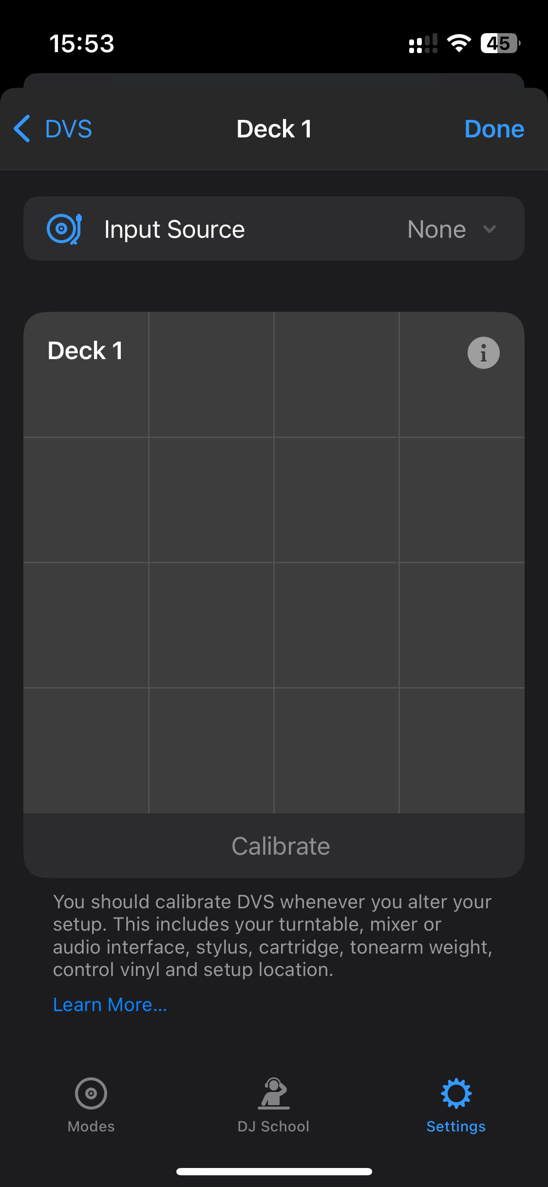

Configuring your turntables​
  1. Choose the appropriate input for each turntable on your audio interface.
    DVS input
  2. Choose your input source and tap Calibrate to begin timecode calibration.
    DVS calibration
  3. Follow the on-screen instructions.
  4. Repeat for each connected turntable.

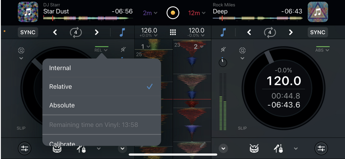

When DVS is enabled, djay Pro updates the interface to include a DVS menu next to the transport controls or jog wheels. This menu shows the current control mode for each deck and lets you switch between different DVS modes.
DVS controls
Internal: Internal mode ignores the timecode signal and uses the djay Pro transport controls instead.
Relative: Uses the timecode signal to play, rewind, and fast forward, but ignores the position of the music in relation to where the needle is on the record.
Absolute: Absolute mode, which will track the music with the timecode record, so that when you drop the needle on the record, it will move the playhead in the music to the equivalent location. Because this keeps the position of the song tied to the position on the vinyl it disables cue points and loops.
Remaining time on vinyl: Shows how much time is left on the record’s track.
Calibrate: Gives you a quick-access menu to the DVS preferences.
When DVS is connected, a DVS section also appears in the options toolbar to give you access to the same controls.
DVS options can be set on a per-deck basis, so you can run some decks with turntables in absolute/relative mode, and others running internally.
