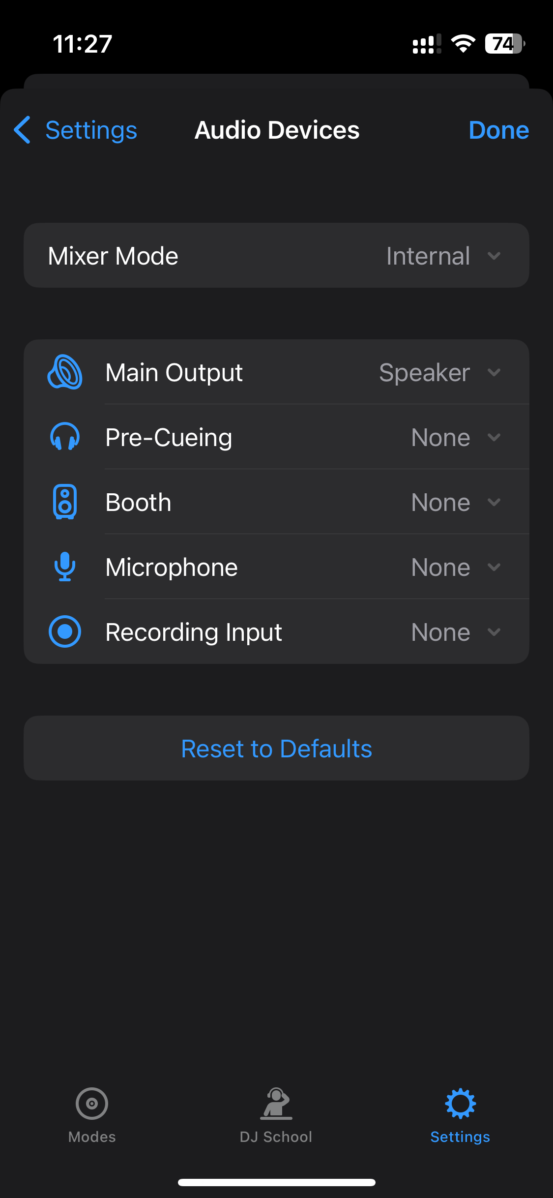

Internal mixer settings
Internal mixing options​
If you're using djay to control audio internally, you’ll find these routing options:
  • Main Output: Select the stereo output for your main audio signal—usually your speakers or PA.
  • Pre-cueing: Select the stereo output for headphone monitoring. This is how you beatmatch and prepare your next track.
  • Booth: Choose a separate output just for your booth monitors (Optional). Only available in internal mixing mode.
  • Microphone: Choose your mic input source. Disable it if you’re not using a mic to avoid unwanted noise.
You can pre-cue using a stereo/mono DJ split cable or by connecting a DJ controller with a built-in audio interface. Learn more about pre-cueing

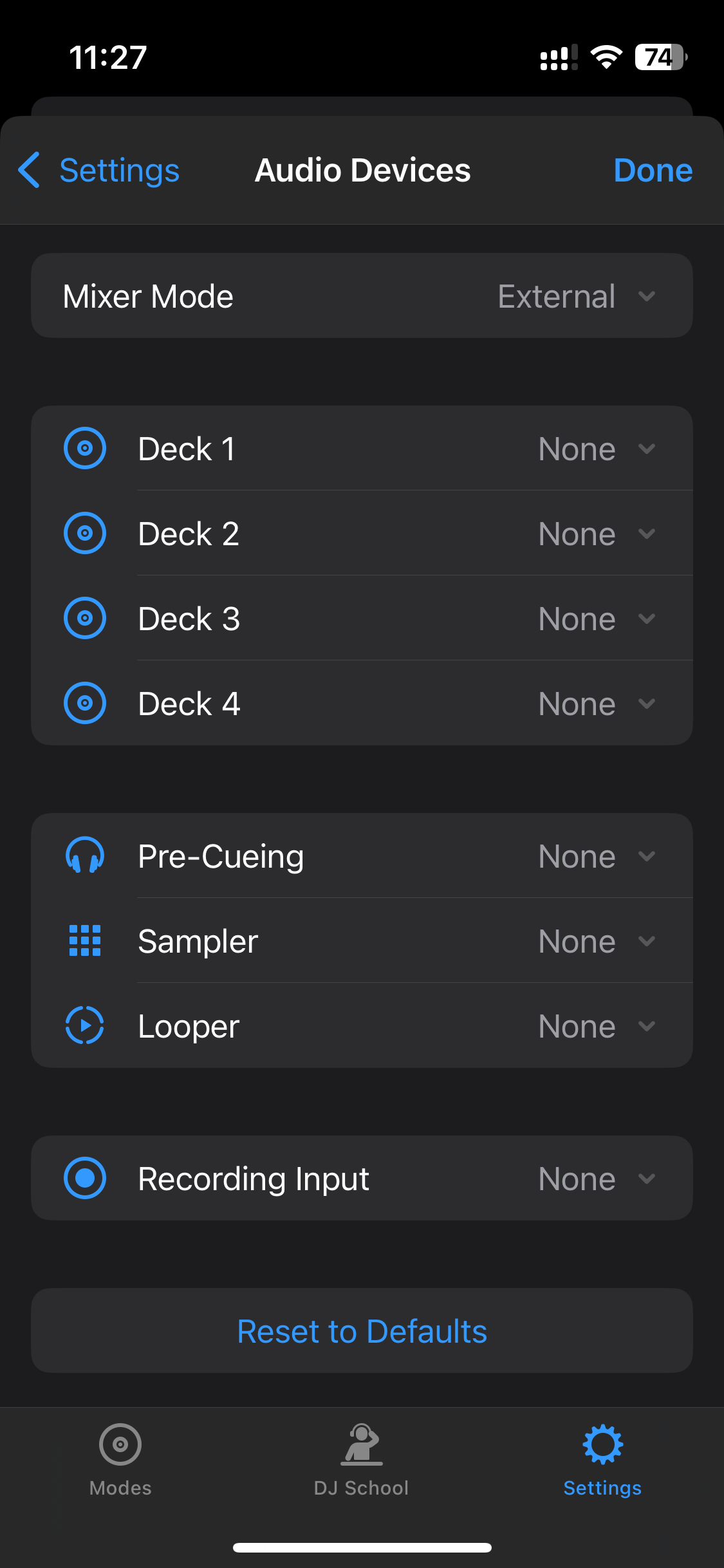

External mixer settings
External mixing options​
When using an external mixer and multi-channel interface, configure each deck and channel separately:
  • Decks 1–4: Assign stereo outputs for each deck.
  • Pre-cueing: Select the output used for headphone cueing.
  • Sampler: Assign a separate output for the Sampler.
  • Looper: Assign a separate output for the Looper.
  • Recording Input: Choose the input for recording via microphone or external line-in.
To output four decks to a four-channel mixer, you'll need an audio interface with at least four separate stereo outputs. Go to the Connecting hardware section for more on hardware setup.
