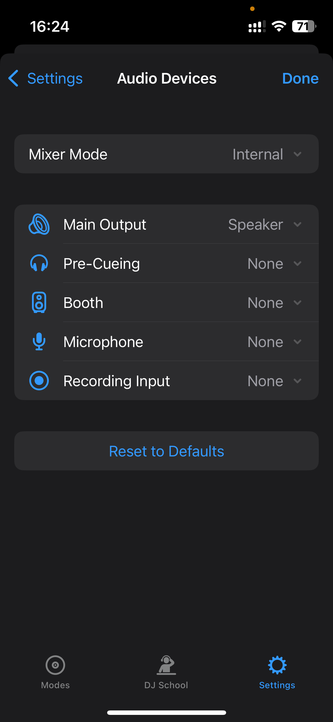

Audio Devices settings
Mixer mode​
  • Internal mode: djay's software handles all the audio mixing internally, giving you a single stereo output for your mix. Perfect for mixing inside djay (e.g. on your Mac or with a MIDI controller).
  • External mode: djay routes the audio to separate channels, which can then be mixed by an external hardware mixer. For example, if you connect an external mixer or audio interface.
Main output​
The main output is where you want to hear the stereo output from. For example, you can select your device speakers or external headphones.
Pre-cueing​
Pre-cueing lets you listen to the next track in your headphones (without anyone else hearing it) while the currently playing track plays through the speakers. This helps you beatmatch, adjust EQ, and prepare transitions before bringing another song into the mix.
There are two ways to pre-cue tracks in djay:
  • Select Split Output and connect a stereo/mono DJ split cable.
  • Connect a DJ controller or supported audio interface.
Using Split Output​
If you don't have a controller or external sound card and you’re DJing directly from your iOS device, you can still pre-cue using Split Output.
When you select Split Output in Settings > Devices > Pre-cueing:
  • The Master output (what your audience hears) goes to one side of the stereo channel.
  • The Cue output (what you hear in your headphones) goes to the other side.
To make this work, use a stereo/mono DJ split cable. This special cable separates the left and right channels into two mono outputs—one for your speakers and one for your headphones—so you can monitor your next track privately in the headphones.
Pre-cueing is not supported in combination with AirPlay or Bluetooth devices.
For more information on pre-cueing, go to the pre-cueing page.
Setting up audio without a controller​
If you’re mixing without a controller, djay lets you route your audio entirely through your Mac. You can set your main output, enable pre-cueing, and choose your preferred mixer mode directly from the audio settings.
If you’re mixing directly on your device:
  1. Go to Settings > Audio Devices.
  2. Make sure your Mixer Mode is set to Internal.
  3. Select your Main output (e.g. where you want to hear the sound from. For example, your device speakers or external headphones).
  4. Choose whether you want to use Split output for pre-cueing. Remember you need a stereo/mono DJ split cable to make it work properly.
  5. Tap Apply to save your audio settings.

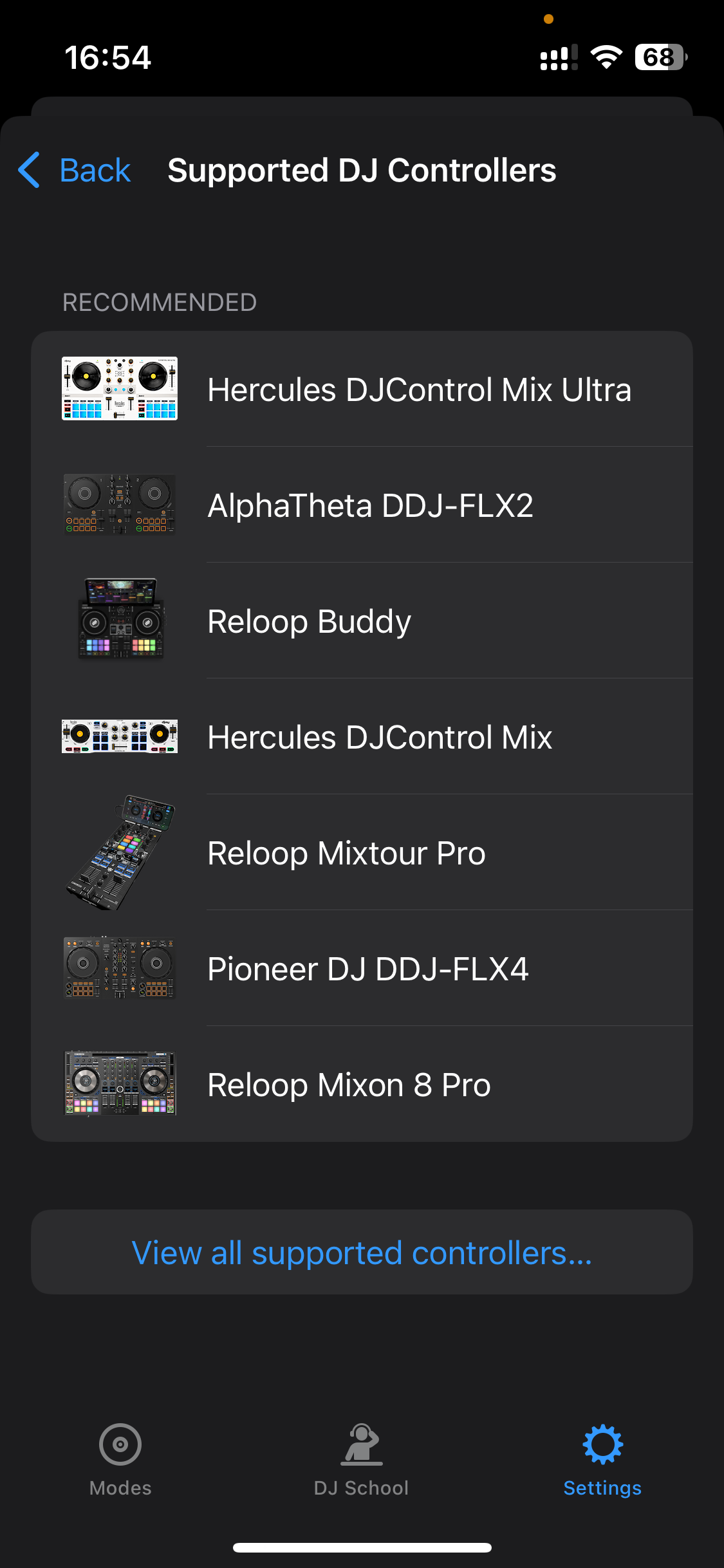

Setting up audio with a supported controller​
When you connect a supported (plug-and-play) DJ controller, djay will automatically configure your audio for you. You can view the full list of officially supported controllers on the DJ Gear page.
If you’re mixing with a supported MIDI controller:
  1. Connect your controller via Bluetooth or an available port. Turn the controller on using the ON/OFF switch or power button, if needed.
  2. When the controller is detected, follow the on-screen instructions.
  3. djay will automatically detect the controller and configure the audio for you.
  4. You should now be able to control djay using your hardware.
For more information on audio settings, go to the Customization & Settings section.
Supported DJ controllers
