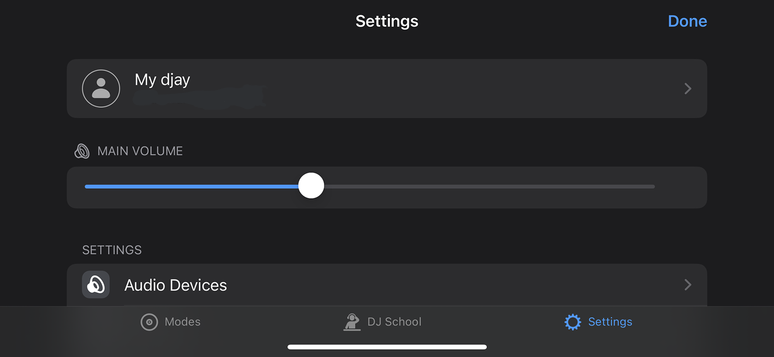

Adjusting the main volume​
  1. Tap the Dashboard button.
  2. Tap the Settings tab.
  3. Move the Main volume slider to adjust the output level.
Main volume slider

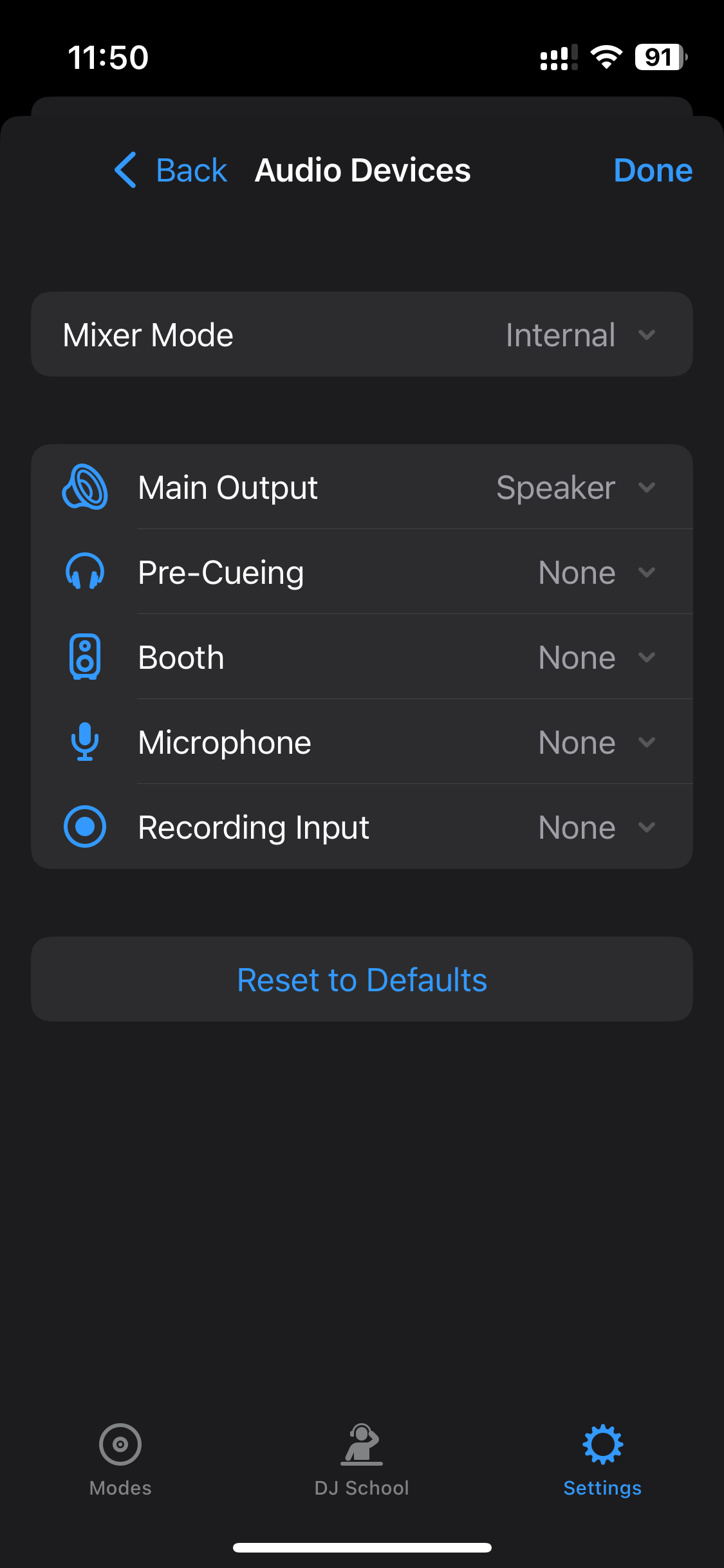

Audio settings​
To change audio settings or device preferences, open Audio Devices in Settings.
Audio devices
Mixer mode​
Switch between two modes depending on your setup:
  • Internal mode – for mixing inside djay (for example, with a MIDI controller).
  • External mode – for routing audio to an external mixer or audio interface.
Choose the mode that matches your hardware. Go to the Audio setup and pre-cueing section for details.
Main output​
Select the stereo output djay uses for your main mix, such as speakers, a sound system, or your device’s built-in speaker.

Booth​
When DJing live, the Booth output sends your mix audio to a separate speaker setup just for the DJ booth, letting you change the volume independently of what the dance floor hears. The booth output duplicates the main mix to a second output.
Booth is only available while in internal mixer mode. Many DJ mixers offer their own booth output controls.
