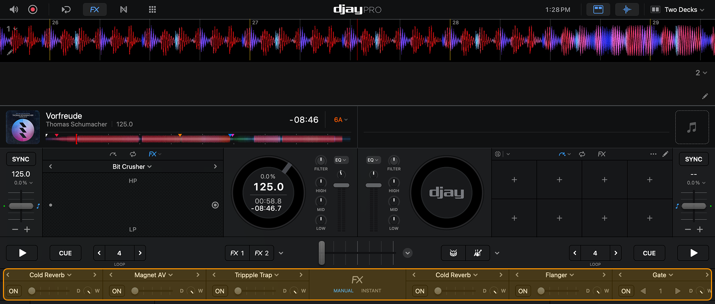

The Effects toolbar is designed for flexibility, letting you switch between Manual and Instant modes depending on how you like to perform. Whether you want fine control over multiple effects per deck or fast, one-click triggers, the Effects toolbar puts creative sound-shaping tools within easy reach.
To open the Effects toolbar, click the FX bar in the main toolbar.
Manual and Instant effects toolbar
The Effects toolbar shows all available effects via the toolbar. In the center, you can switch between showing Manual or Instant effects.
Manual effects​
Access up to three effects per deck and change them by clicking the effect name. Use the controls beneath each effect to turn them on/off, adjust the dry/wet mix, and control effect intensity.
Manual effects
You can click the effect name and route each effect to the drums, harmonic, or vocal stems using FX routing.
FX routing
