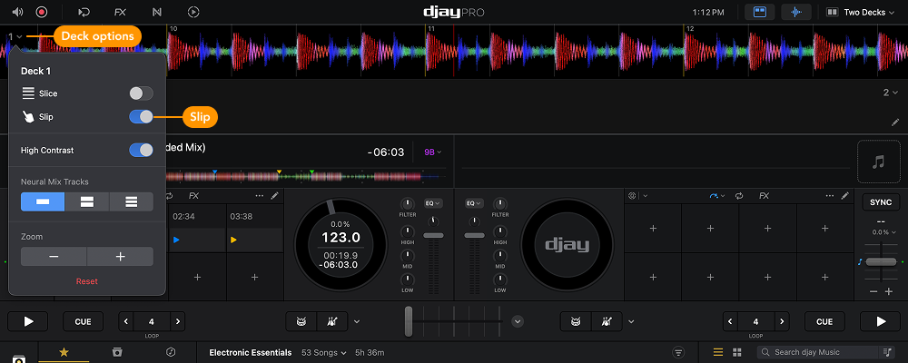

How to enable Slip Mode​
  1. Click the Slip button in the Deck options dropdown menu.
  2. Press ⌘ + PLAY to start the selected deck with Slip Mode activated.
