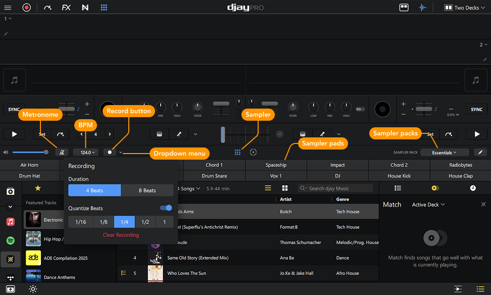

Building a sequence
How to record a sampler sequence​
  1. Click the Sampler icon in the toolbar beneath the crossfader.
  2. Choose and load a sample pack from the sampler packs dropdown menu.
  3. Start playback on a track if you want to sequence over a song, or build a loop on its own.
  4. Click the metronome icon to enable the click track. If a track is playing, the metronome syncs to its BPM. If not, it uses the BPM that’s set in the Recording options.
  5. Click Record to begin sequencing.
  6. Listen for the downbeat in the metronome—it has a slightly higher pitch than the other beats. A visual indicator also shows your current position in the loop.
  7. Start building your rhythm by clicking the pads in the grid. You can overdub (record over the existing sounds) by playing additional sounds over the existing sequence.
You can switch sample packs while recording to swap out sample sequences on the fly.
