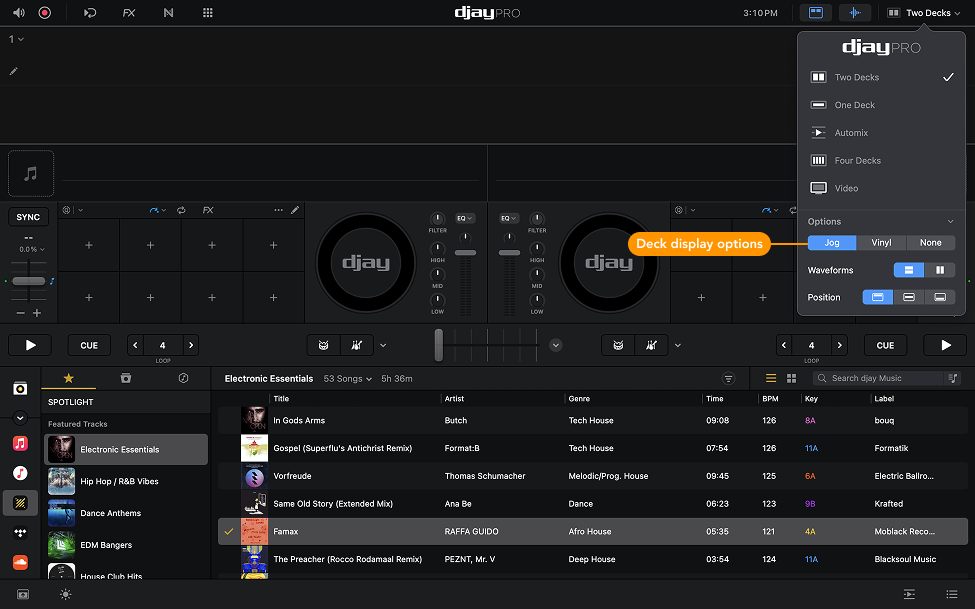

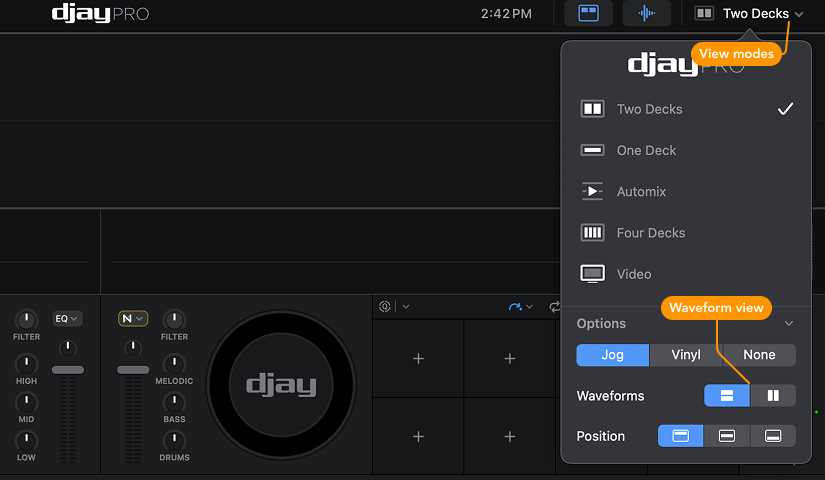

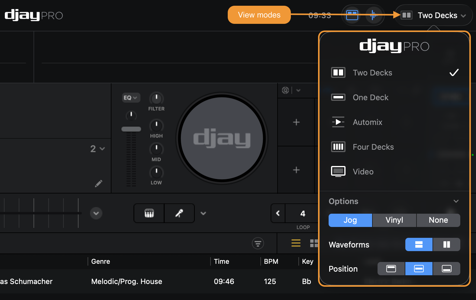

djay offers multiple deck views, along with a set of display options, so you can choose the layout that best fits your style, needs, and setup. You can switch between different deck views, and adjust these options, from the View Modes dropdown menu in the top right corner.
View modes and options
Deck display options​
If you choose two deck, four deck, or video view, you will see additional options to further customize the layout. The display options available depend on the view that you have chosen.

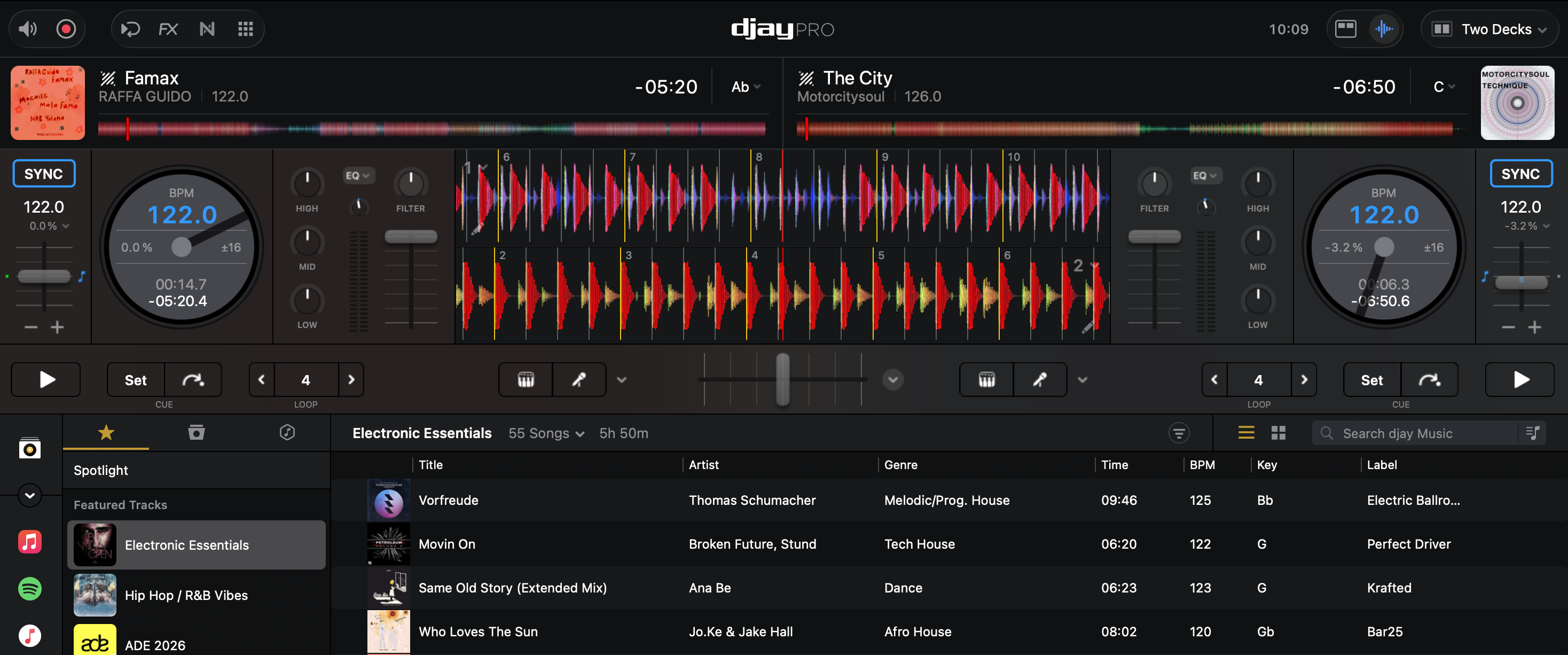

Two Decks​

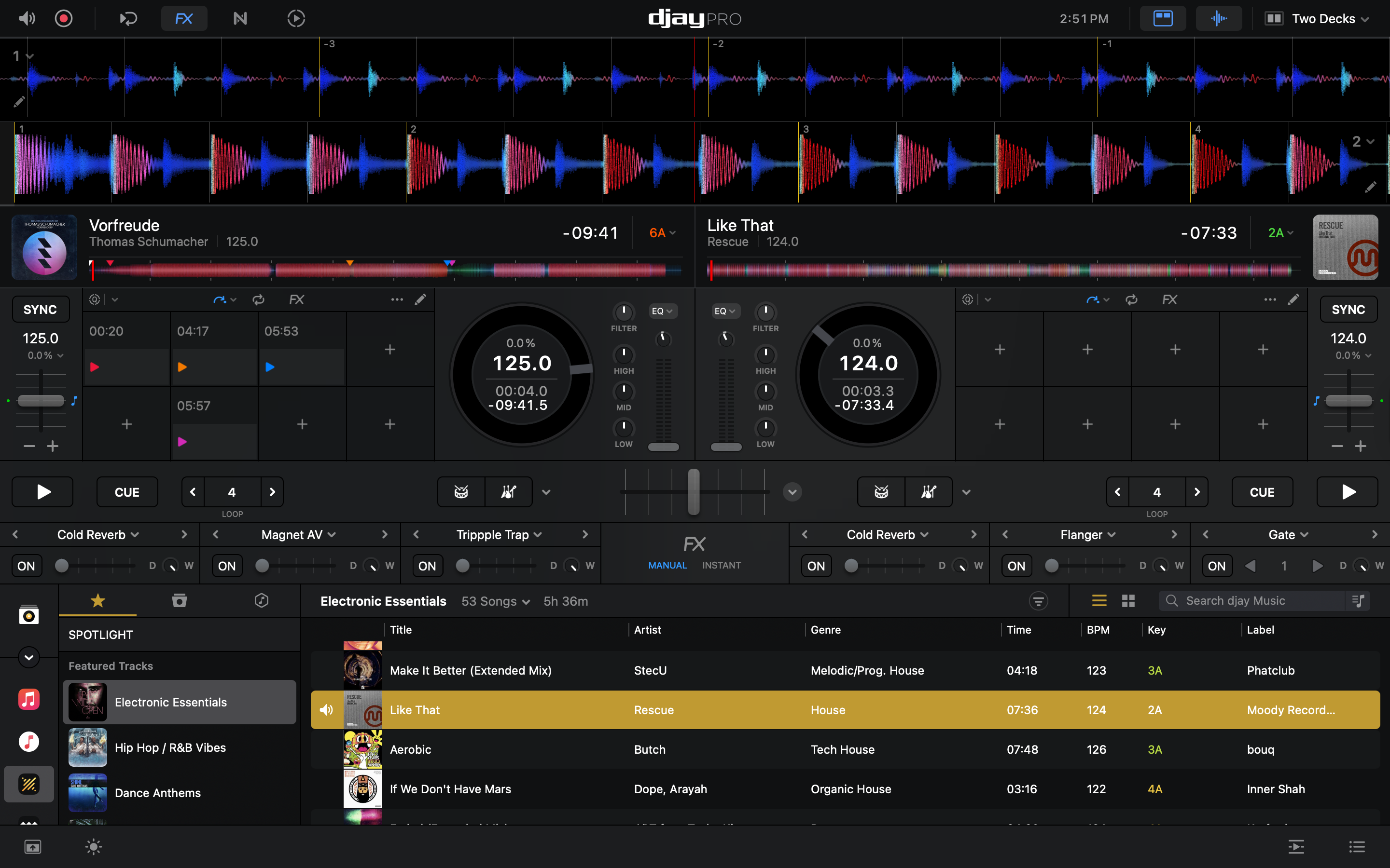

The default layout in djay Pro displays two decks with virtual jog wheels that emulate the look and feel of traditional DJ hardware. This is where you'll find the full crossfader and mixer controls, ready for mixing live between two tracks.
Two deck view

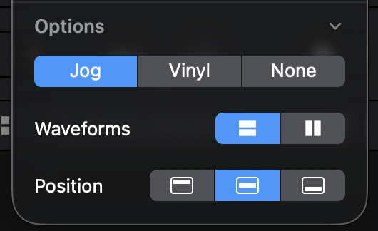

In Two Decks view, you can choose how you want the decks to look: Jog view shows virtual jog wheels, Vinyl shows virtual vinyl platters, and None hides both so the waveform takes up the full deck.
Display options
You can also choose either horizontal or vertical waveforms. Horizontal waveforms show a longer section of the scrolling track, while vertical waveforms save space and allow for a more compact layout. With the vertical layout, you can additionally configure the position of the waveform in relation to the decks; above, inbetween or below.

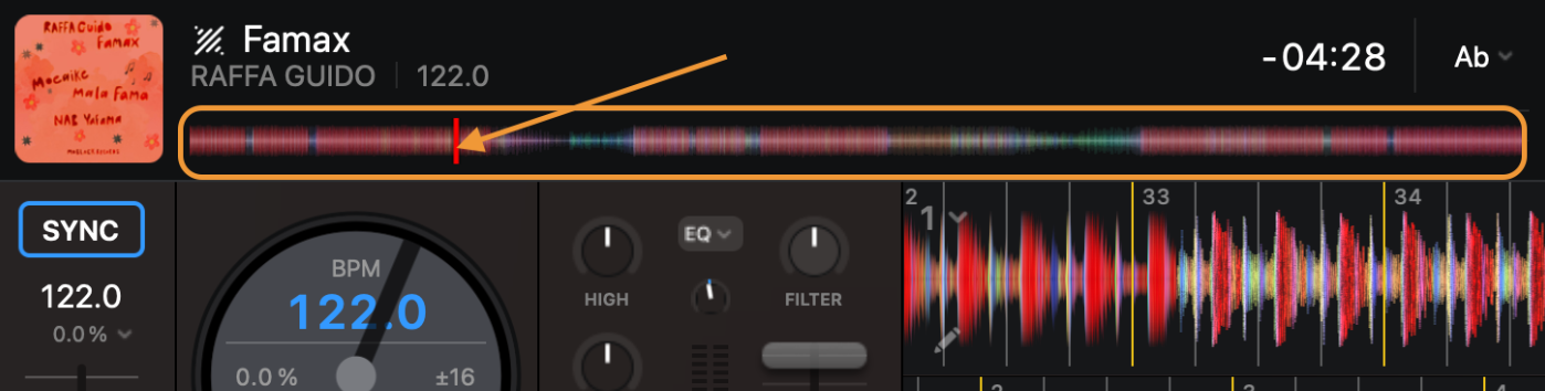

In both horizontal and vertical waveform views, you can use the waveform overview to see the waveform's position on the track. Clicking anywhere in the waveform overview will jump to that part of the track.
Waveform position

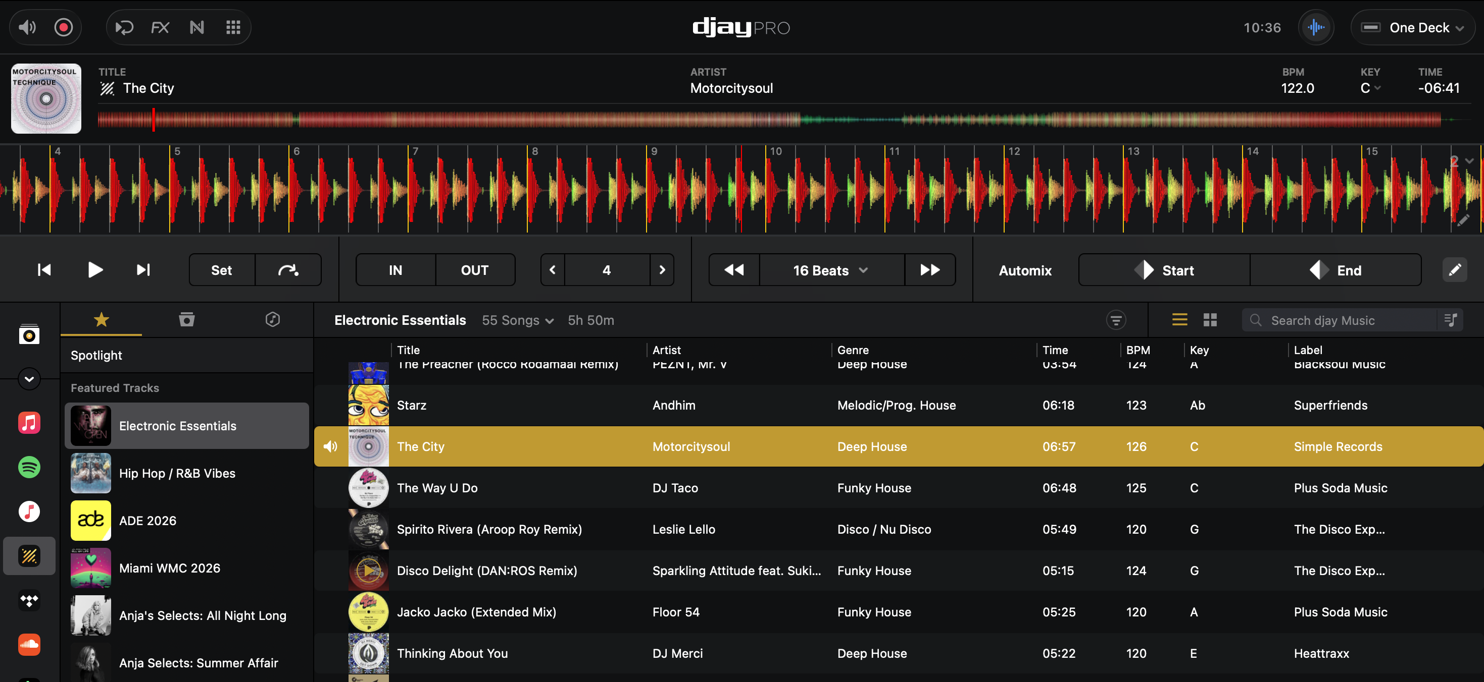

One Deck​

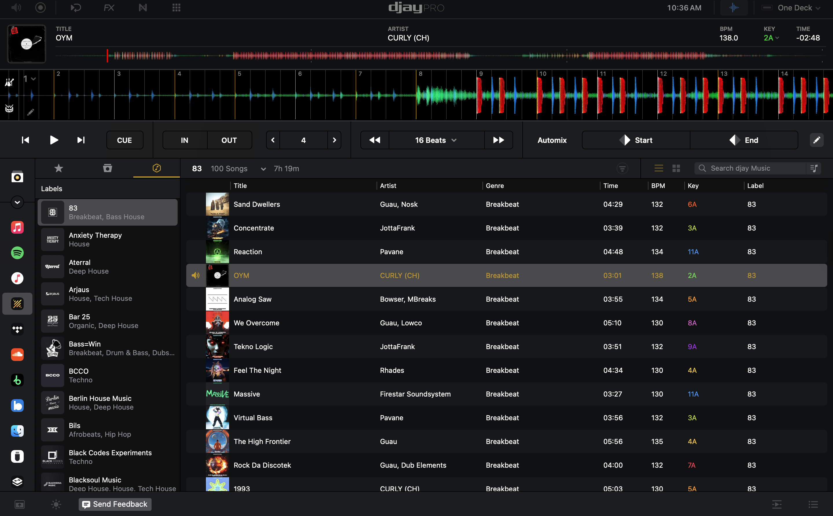

The One Deck view lets you focus on a single track at a time, perfect for preparing your set or casual listening.
One deck view
One Deck clears away the crossfader, second deck, and mixer controls, so it gives you more screen space than any other view. That's what makes it the ideal view to use when you're getting ready for a set rather than performing one. Use it to:
  • Create and manage playlists, edit metadata, and tag and organize your library
  • Set cue points
  • Set loops
  • Set Automix start and end points
  • Adjust a track's beatgrid on the expanded, full-screen waveform
  • Browse and audition new tracks, for music discovery or casual listening
When you're ready to perform or mix tracks together, switch back to Two Decks or Four Decks.

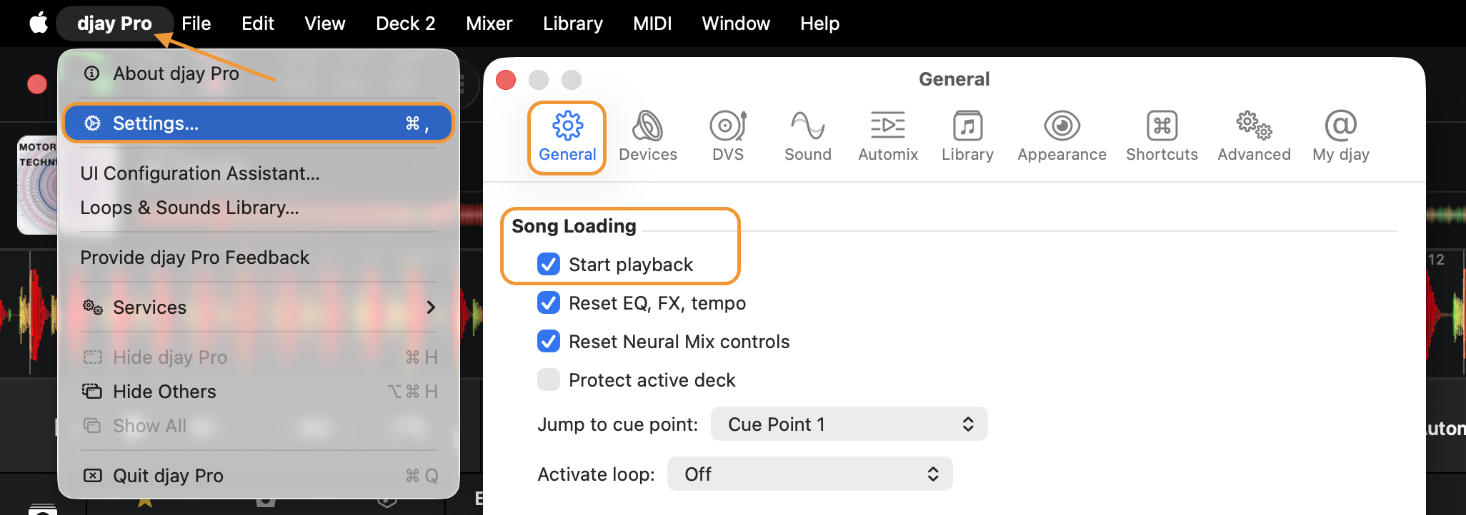

One Deck can also be used to play your tracks in a playlist straight through, one after the other. This might be preferrable to using Automix which transitions between the songs (more about that below). In One Deck mode, when the track you're playing reaches its end, djay automatically loads the next track from your playlist. That makes it a good fit for anything where you just want your music to keep going on its own, background music at an event, a long recording session, or casual listening, without having the transitions the way you would with Automix.
To set this up:
  1. Go to Settings > General > Song Loading and turn on Start Playback.
Song Loading settings with Start Playback turned on
  1. Switch to One Deck view.
  2. Load the first track in your playlist and press play.

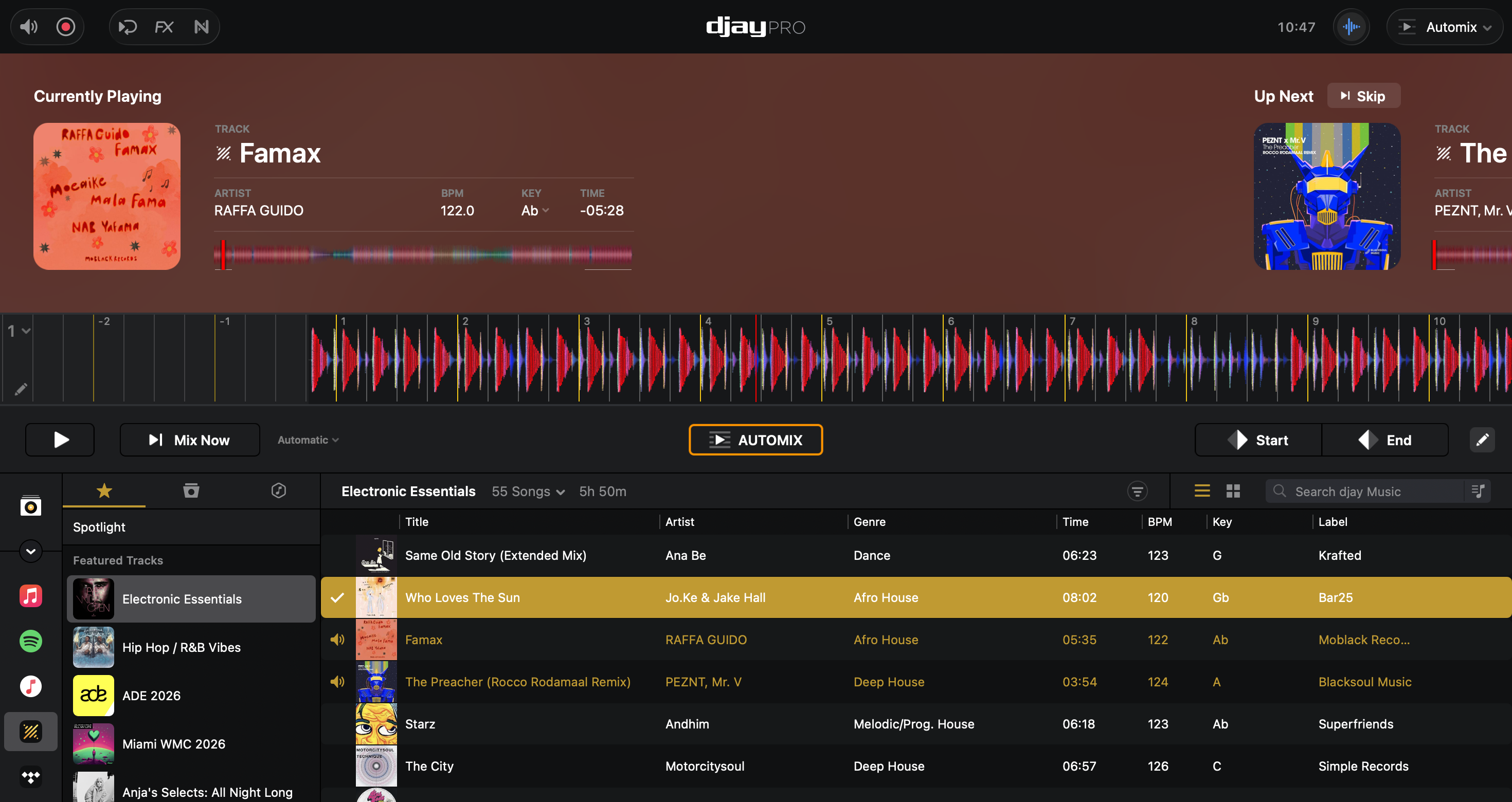

Automix​

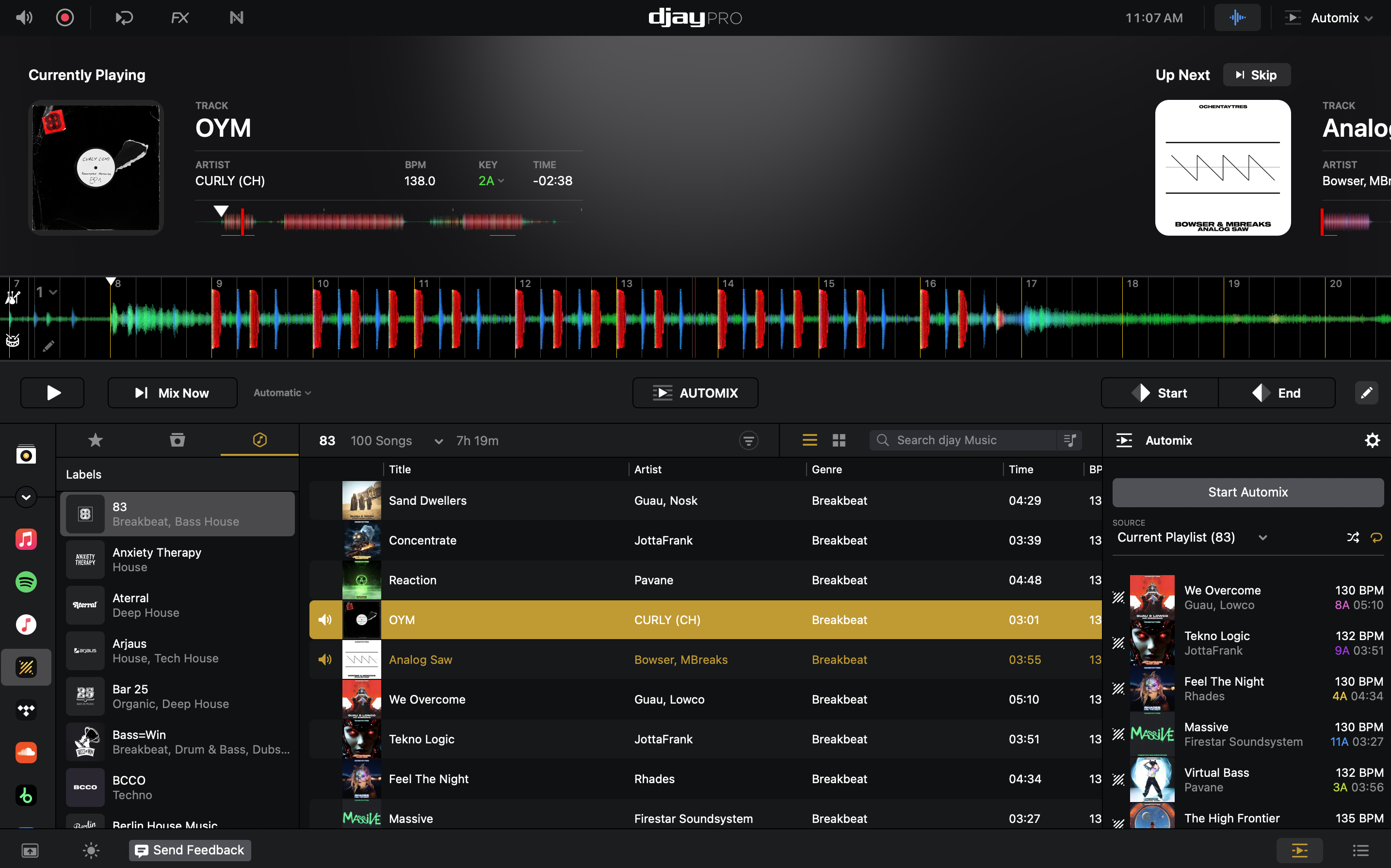

Automix mode automates track transitions, allowing you to step away from the decks, without interrupting the playback.
Automix view
For the full walkthrough, including mix settings and transition types, see Using Automix.

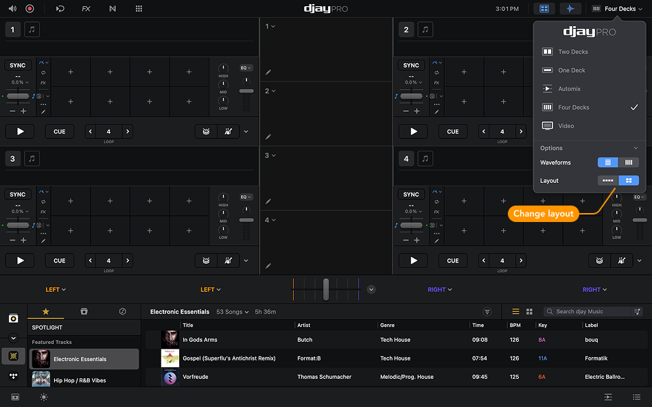

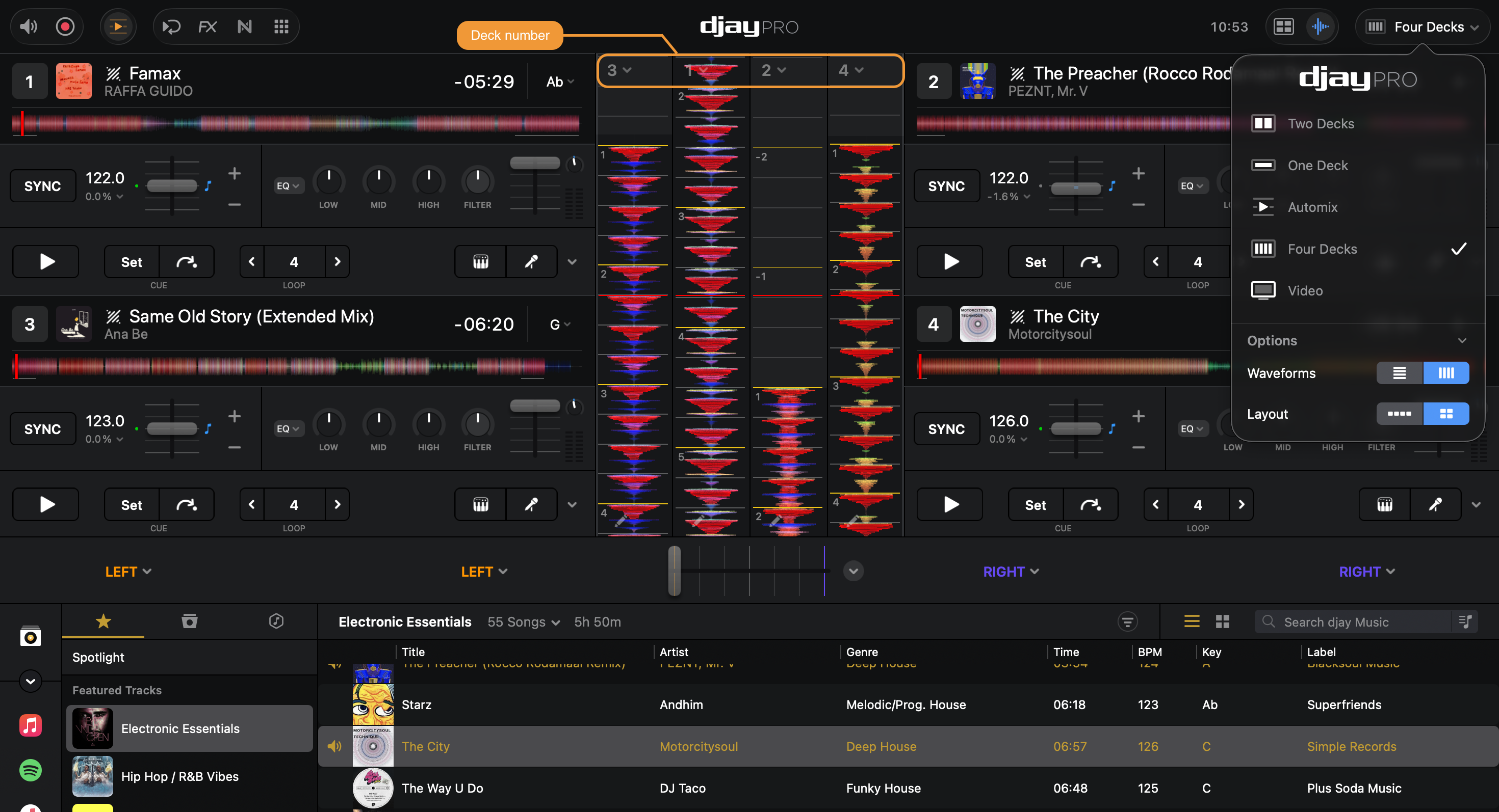

Four Decks​

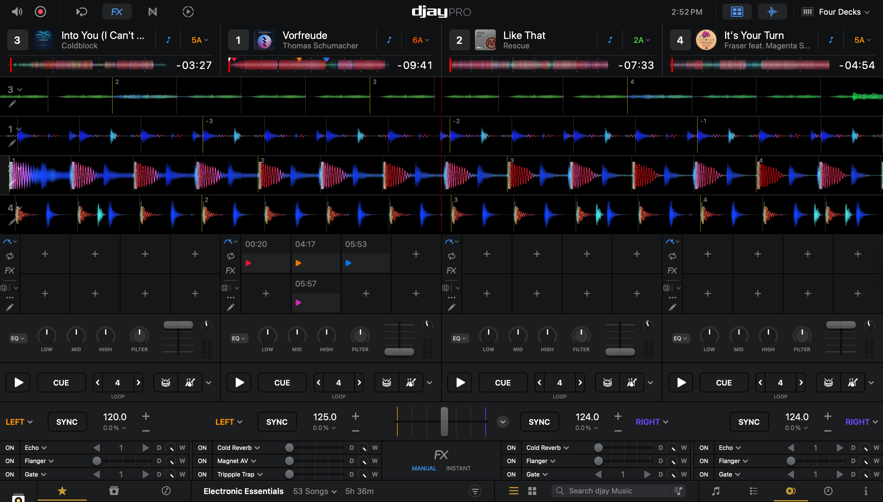

In Four Decks mode, you can mix live between four tracks. It's similar to the two-deck layout, but with a few changes to the interface to fit the extra controls.
In Four Decks mode, you can also choose horizontal or vertical waveforms. Vertical waveforms save space and allow for a more compact layout, while horizontal waveforms show a longer section of the scrolling track. You can also switch between a parallel layout and a 2x2 grid layout. The corresponding deck is numbered on each waveform.
Four deck view with deck numbers

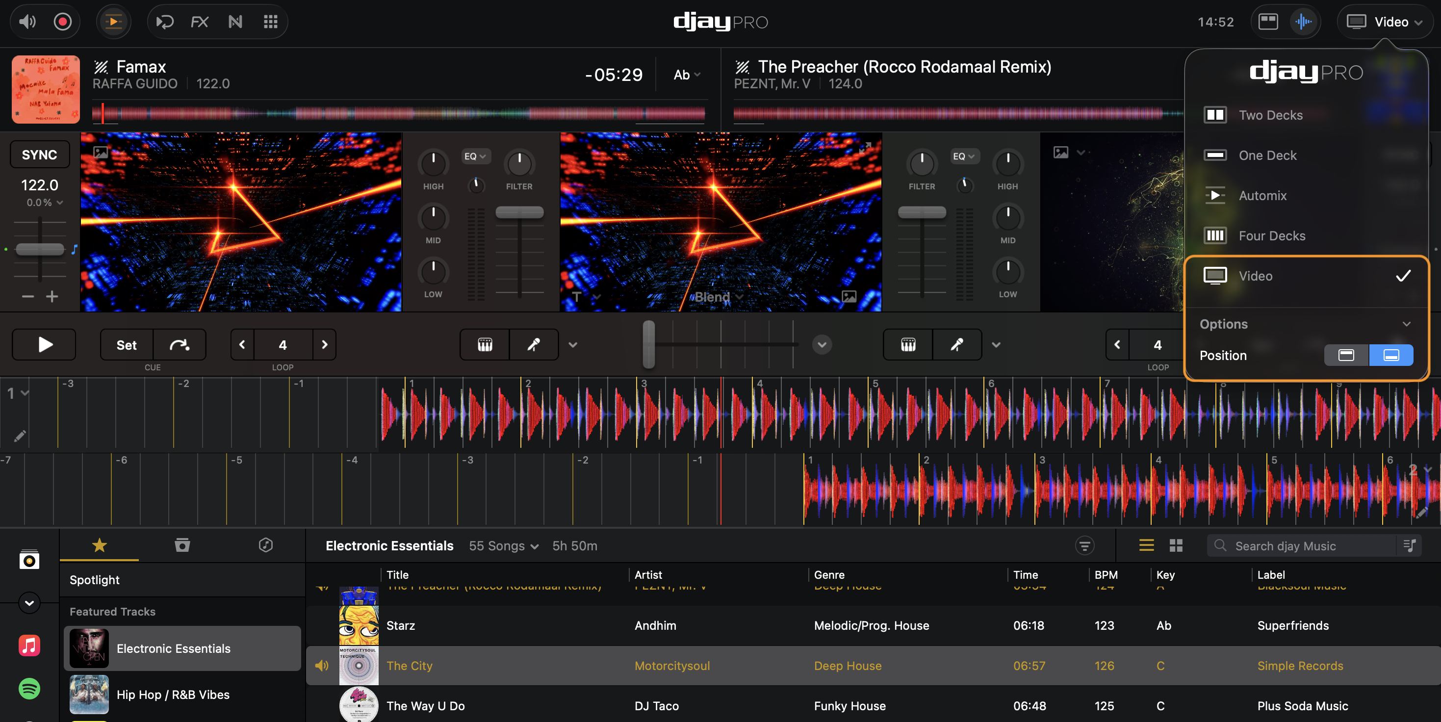

Video​
djay lets you mix video with the same ease and control as audio. When Video mode is chosen, you also have the option to position the waveforms above or below the video preview display. For the full rundown on DJing with video, cueing and mixing clips, outputs, and effects, see Video decks.
