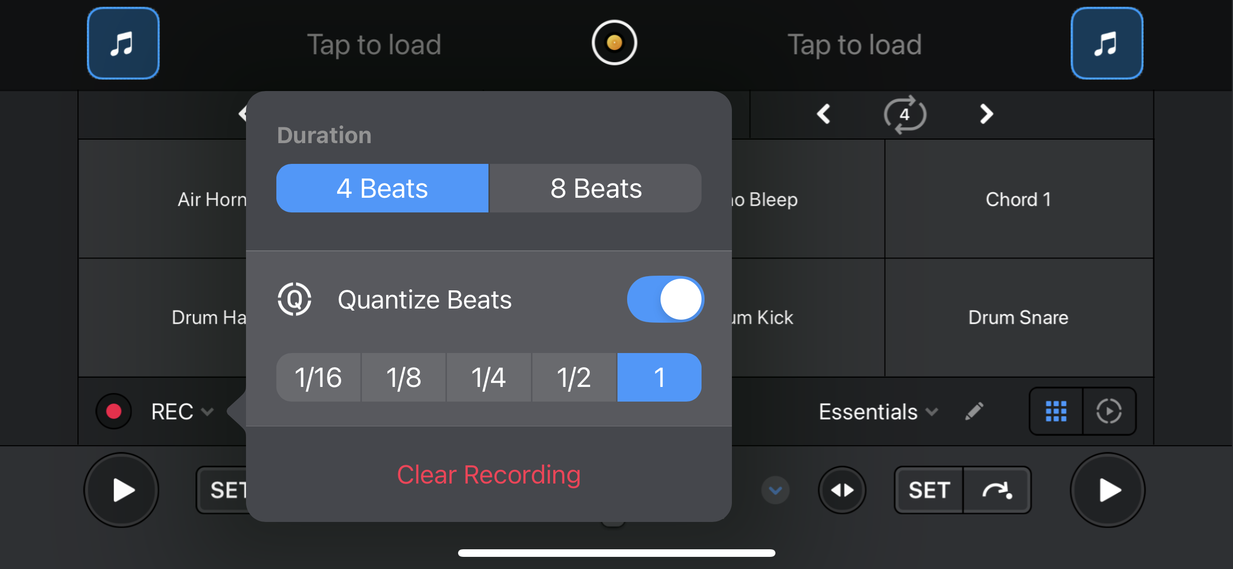

The default loop length is one 4-beat bar, but you can extend it to 8 beats and adjust quantization from the Record options dropdown menu.

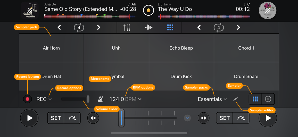

How to record a sampler sequence​
  1. Tap the Sampler icon in the toolbar beneath the crossfader.
  2. Choose and load a sample pack from the sampler packs dropdown menu.
  3. Start playback on a track if you want to sequence over a song, or build a loop on its own.
  4. Tap the metronome icon to enable the click track. If a track is playing, the metronome syncs to its BPM. If not, it uses the BPM that’s set in the Record options.
  5. Tap Record to begin sequencing.
  6. Listen for the downbeat in the metronome—it has a slightly higher pitch than the other beats.
  7. Start building your rhythm by tapping the pads in the grid. You can overdub (record over the existing sounds) by playing additional sounds over the existing sequence.
You can switch sample packs while recording to swap out sample sequences on the fly.
