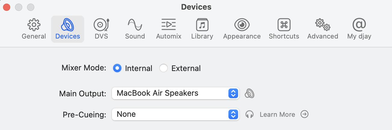

You’ll find these in djay’s Settings > Devices tab.
Pre-cueing requires a PRO subscription and is not available in the free version.

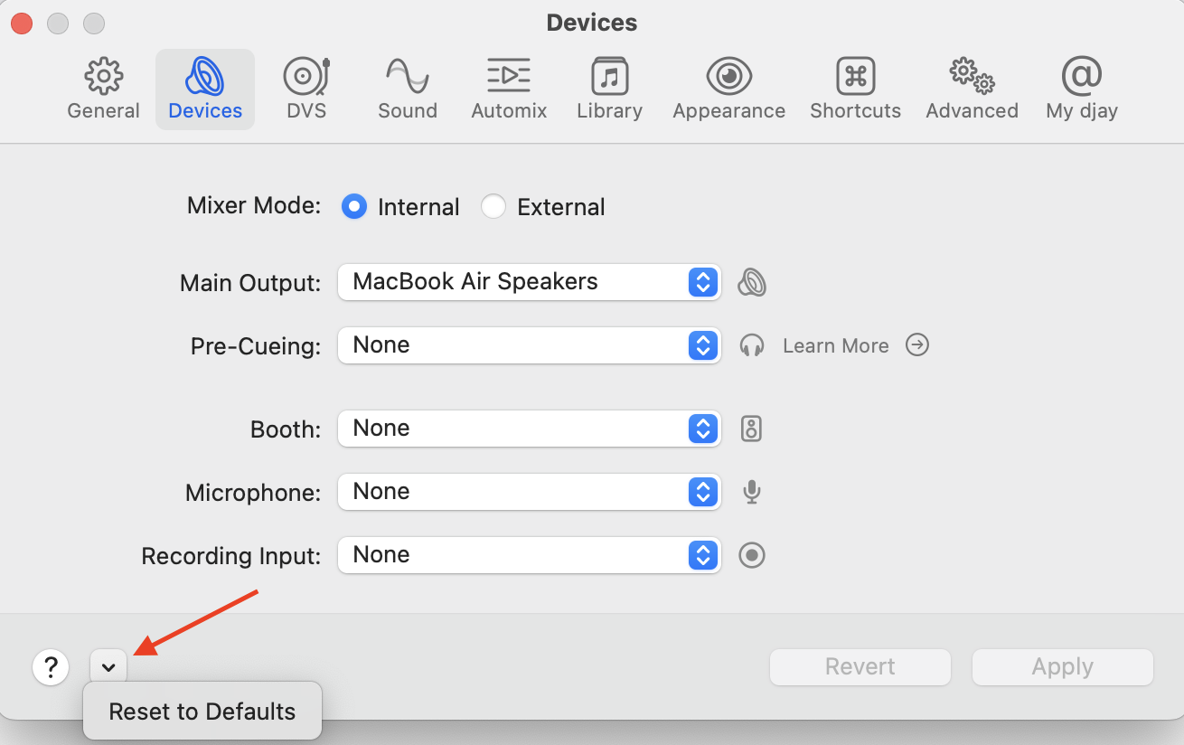

Mixer mode
Internal mode
djay mixes all audio internally, providing a single stereo output.
This mode is recommended when mixing directly on your Mac or when using most MIDI controllers. -
External mode
djay sends audio to separate channels, allowing mixing with an external hardware mixer or multi-channel audio interface.
Mixer mode is determined by your hardware, so the goal is to match what the device expects, rather than your personal preference.
If mixer mode is changed manually in djay:
- audio may come out of the wrong outputs
- one deck may play only on the left or right channel
- pre-cueing may stop working
- the hardware may not respond as expected
If this happens, don’t worry — use Reset to Defaults in djay’s audio settings. This restores the correct routing for your specific controller or mixer.
Previewing tracks directly in djay’s media library is generally not available when using hardware in External Mixer Mode. In this mode, djay sends each deck’s audio to separate channels on the device’s mixer, which handles headphone cueing internally via its pre-cue buttons.
To preview tracks from the media library, the hardware must provide dedicated pre-cue channels that djay can access directly. If such channels are available, they can be configured in djay’s devices settings.
Note that this limitation does not affect normal headphone cueing provided by the device’s built-in mixer.
Main output
The main output determines where you hear your master audio signal—for example:
- your Mac’s internal speakers
- wired headphones
- a USB audio interface
- the output of a DJ controller
If you experience issues with your audio routing, try Reset to Defaults in djay’s Audio settings. This restores the default configuration for connected hardware and fixes most common issues.

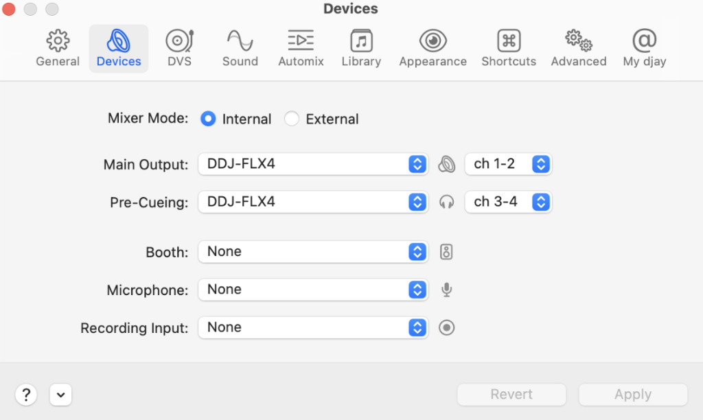

Setting up audio with a supported DJ controller
When you connect a supported (plug-and-play) DJ controller:
- djay will automatically configure your audio settings
- No manual audio setup is required
You can find a full list of supported devices on the
Algoriddim DJ Gear page.
If you’re mixing with a controller:
- Connect your controller and switch it on.
- Follow any on-screen instructions in djay.
- djay will automatically detect the controller and route audio correctly.
- You can now control djay using your hardware.

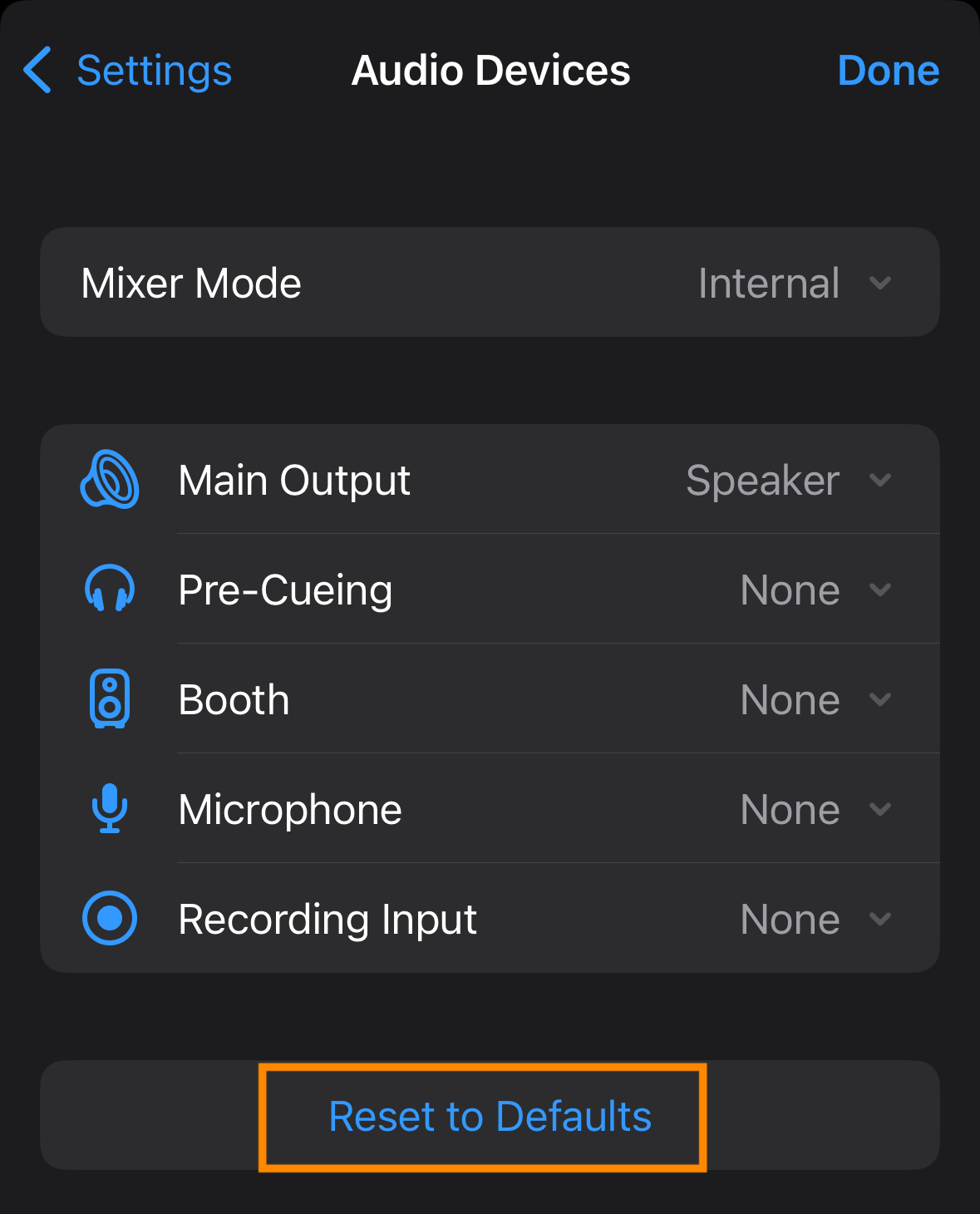

Main output
The main output determines where you hear your master audio signal — for example:
- your iPhone/iPad speakers
- wired headphones
- an HDMI-connected device
- a DJ controller with built-in audio
Select the device where you want the audience to hear the music.

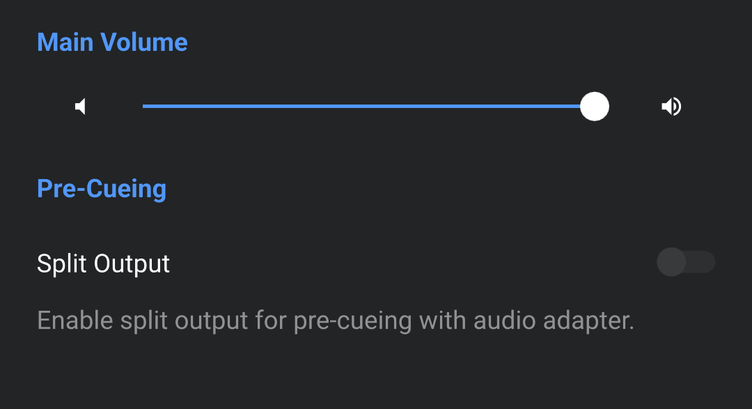

Using Split Output
If you don’t have a DJ controller or external sound card, you can still pre-cue directly on your device using Split Output.
When Split Output is enabled in Settings > Devices > Pre-cueing:
- The Master output (what the audience hears) is sent to one side of the stereo channel
- The Cue output (your headphone preview) is sent to the other side
To use this setup, you’ll need a stereo/mono DJ split cable, which separates the left and right channels into two mono outputs — one for speakers and one for headphones.
For more information, visit the pre-cueing page.

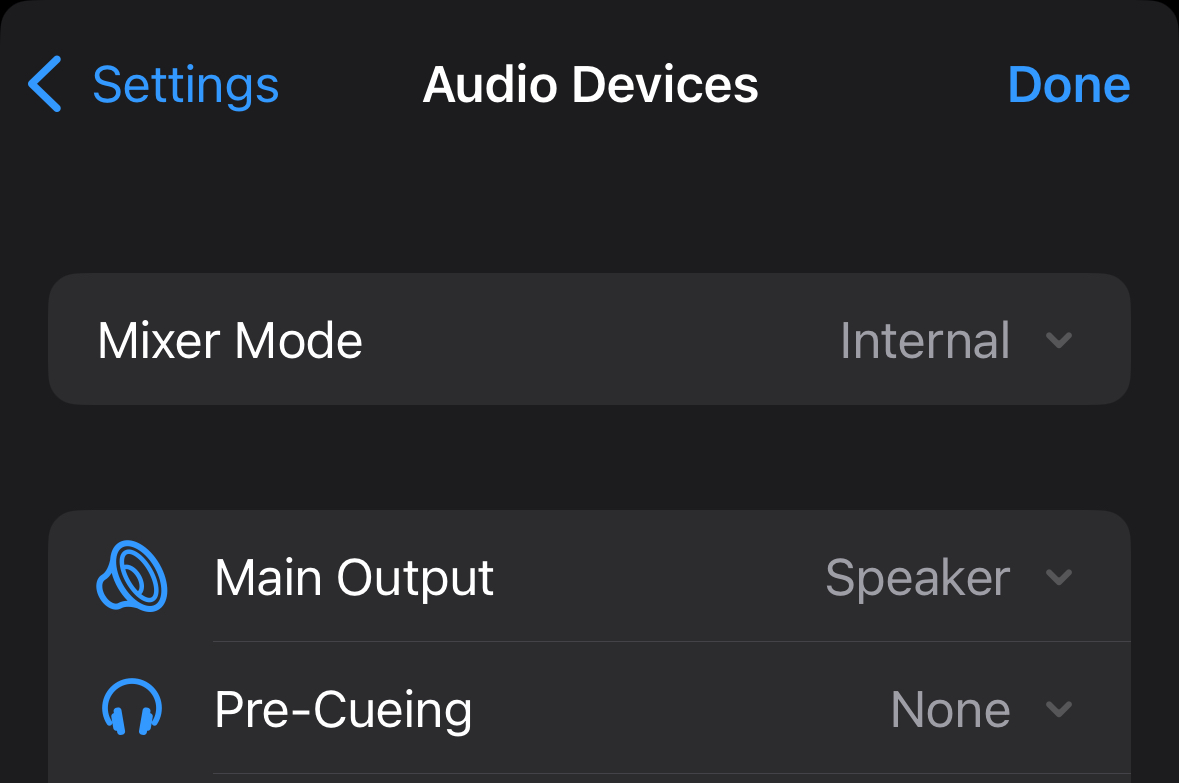

If you're mixing directly on your iPhone or iPad:
- Open Settings > Audio Devices.
- Set Mixer Mode to Internal.
- Select your Main output (e.g. where you want to hear the sound from. For example, your device speakers or external headphones).
- Choose whether to enable Split Output for pre-cueing.
(Requires a stereo/mono DJ split cable.) - Tap Apply to save your settings.

How to test pre-cueing
To make sure everything is routed correctly:
- Load a track into Deck 1 and another into Deck 2.
- Move the crossfader from side to side to confirm:
- The master output plays through your speakers
- The cue signal plays independently through your headphones
If something doesn’t sound right, double-check your Audio Devices settings or reselect your output device.

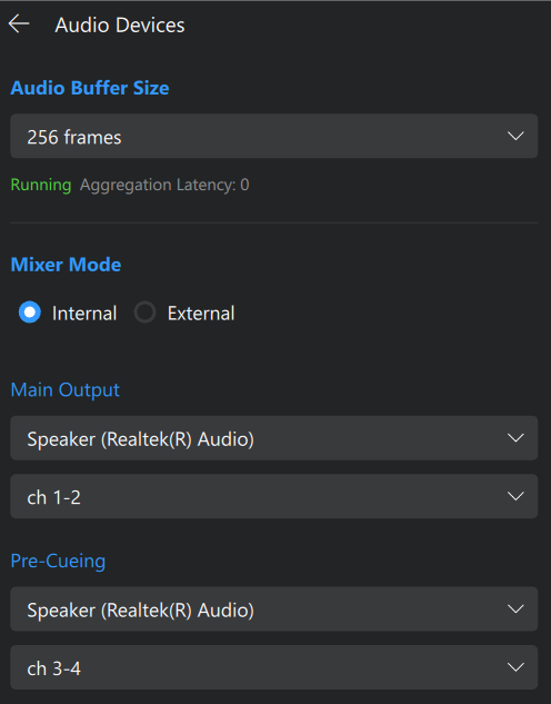

There are four main settings to configure:
- Audio buffer size
- Mixer mode
- Main output
- Pre-cueing

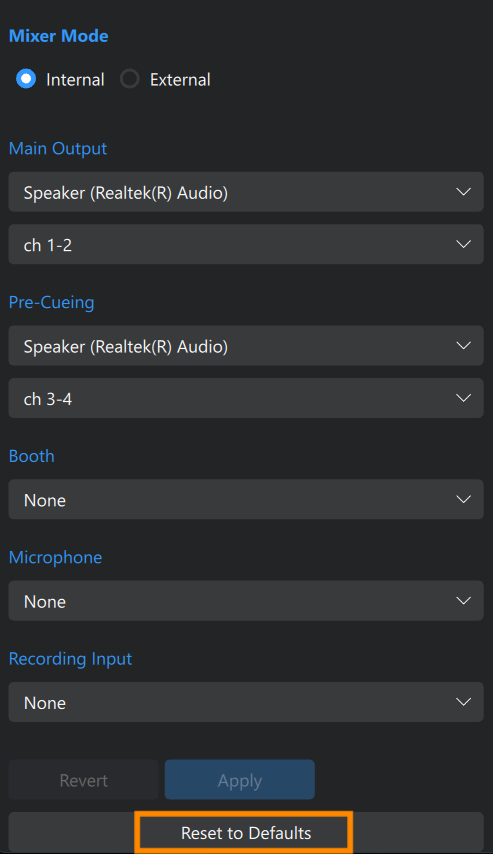

You’ll find these options in Settings > Audio Devices.
Audio Buffer Size
The Audio Buffer Size determines how quickly audio is processed by your system:
- Lower buffer sizes reduce latency and make djay feel more responsive
- Higher buffer sizes increase stability, especially on slower systems
If you hear audio crackling or dropouts, try increasing the buffer size.
Mixer mode
Internal mode
External mode

Some Windows audio devices provide output options for multiple stereo channel pairs, such as:
- ch 1–2
- ch 3–4
- ch 5–6
- ch 7–8
This depends on your system’s audio driver or connected hardware, but we would typically recommend the following setup:
- Set your Main Output to the first stereo pair (usually ch 1–2).
- Set Pre-Cueing to a different pair (such as ch 3–4) to keep the signals independent.

If you’re mixing directly on your Windows PC:
- Select your Main Output (for example, your PC speakers or wired headphones).
You’ll need a stereo/mono DJ split cable for this to work properly.
Click Apply to save your settings.
If your Main Output is set to your PC’s internal speakers, you can plug headphones into the computer’s audio-out (3.5 mm) port and use them for pre-cueing.

Android offers a simplified audio setup compared to other platforms.
While there are fewer settings to configure, you can still achieve reliable pre-cueing—either by using Split Output or by connecting a supported DJ controller or audio interface.
Understanding audio on Android
Unlike other platforms, Android handles most audio configuration automatically.
You won’t see mixer mode options, device selectors, or routing menus.
In Settings, you’ll find:
- Main Volume
- Split Output (for pre-cueing)
All other audio routing is determined by your device hardware or by any connected DJ controller or audio interface.

Using Split Output
Split Output lets you pre-cue directly from your device even if you don’t have an external sound card or controller.
When you enable Split Output in djay:
- The Master output is sent to the left channel
- The Cue output is sent to the right channel
- djay creates binaural mono on both sides, so you hear audio in both ears of your headphones and through both speakers connected to the master channel
To make this work, use a stereo/mono DJ split cable, which separates the left and right channels into two mono outputs—one for speakers and one for headphones.
A generic auxiliary splitter will not allow for pre-cue as it will not properly split the audio signal. For more information, visit the pre-cueing page.
