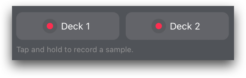

- You may also directly record a sample from one of the decks by clicking and holding the desired button. Note: Due to licensing agreements, it's not possible to record samples from tracks from streaming services.
