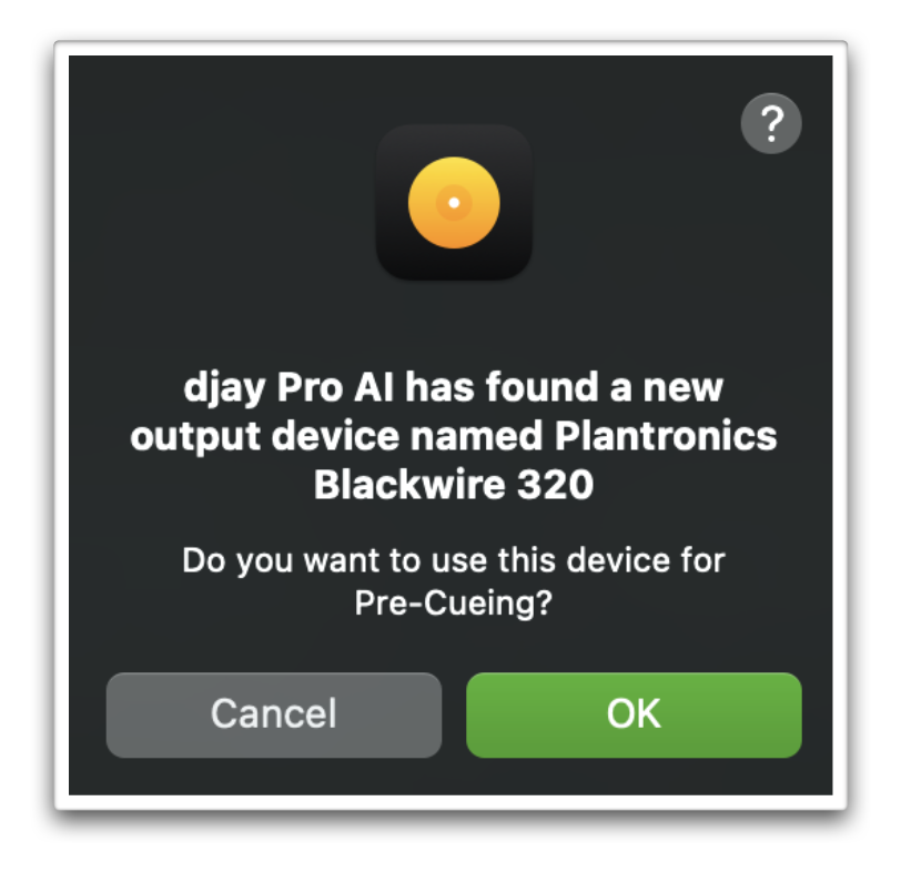

- After djay has detected the device, confirm that you want to use it for pre-cueing.

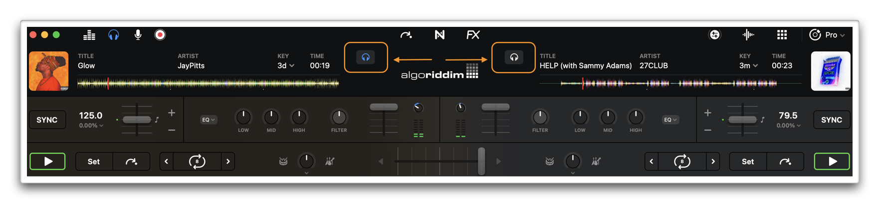

- djay will select the turntable audible through your headphones automatically. To change the currently active turntable, you can use the pre-cueing headphones icon buttons next to the decks.

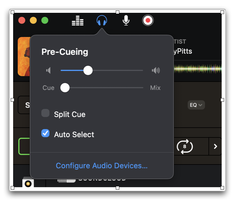

- To change the pre-cueing volume, open the pre-cueing panel using the headphones icon button in the upper left corner of djay’s main window.

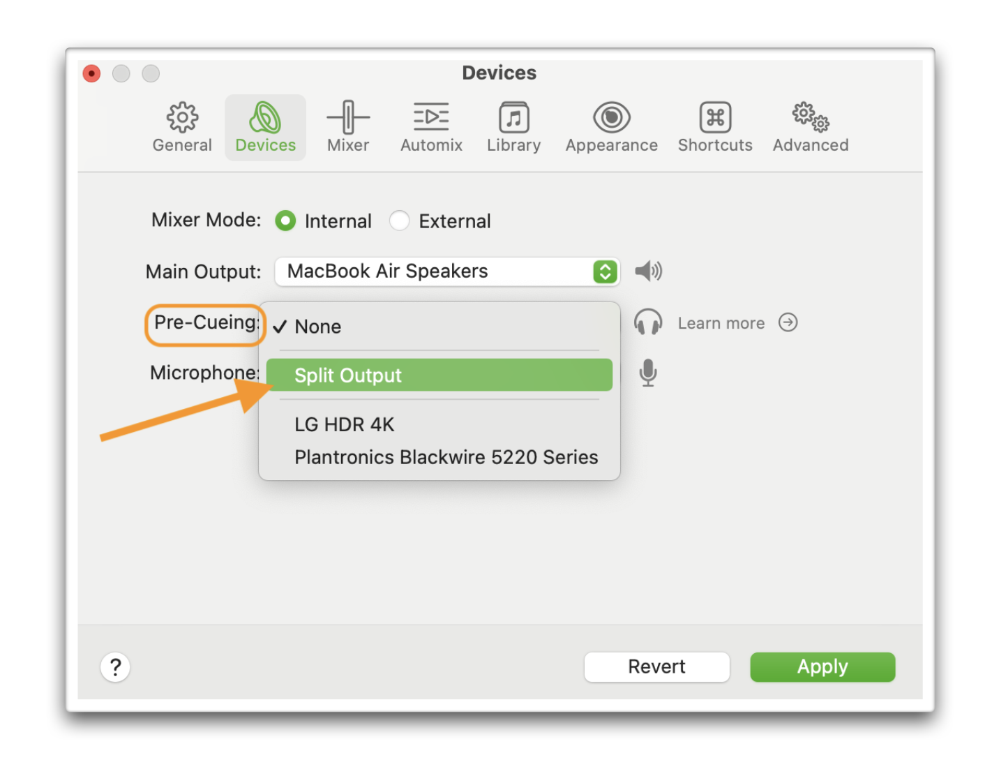

As an alternative, you can also pre-cue with the Split Output option enabled in djay's audio Devices settings, using a stereo/mono DJ split cable (like this one).
djay Pro will send the master output to the left channel and the cue output to the right channel (which is always the opposite turntable to the one audible through the master channel). You will get a binaural signal for master and pre-cueing, so you will hear the same sound on both speakers connected to the master channel and in both ears of the headphones connected to the pre-cueing channel.
