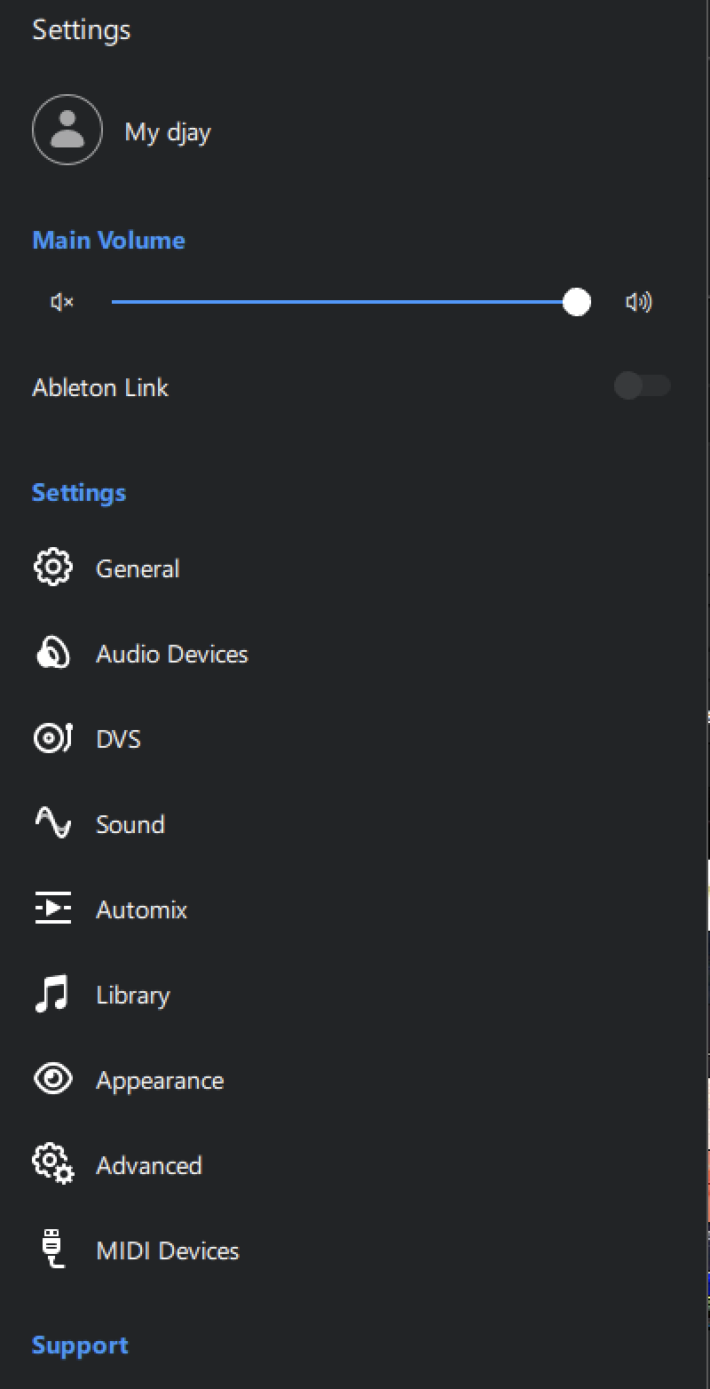

Main Volume​

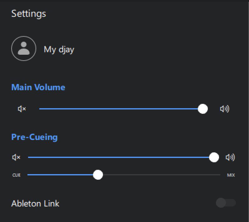

Control your mix’s overall output volume using the Main Volume slider in the main settings. Move the slider left to decrease volume, right to increase it.
Main volumes settings

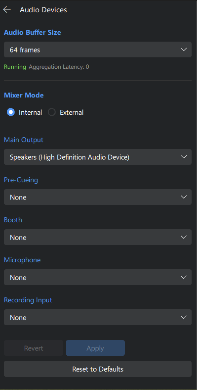

To change your audio settings or device preferences, click Audio Devices.
Mixer mode​
Switch between internal and external mode:
  • Internal mode — for mixing inside djay (e.g. with a MIDI controller)
  • External mode — for routing audio to an external mixer or audio interface
Choose the mode that suits your hardware setup. You can learn more about setting the correct mixer mode in the Audio setup and pre-cueing section.
Main output​
Select the stereo output djay uses for your main mix, such as the audio sent to your speakers or sound system.

When pre-cueing, you can adjust the volume for headphone monitoring, use the Cue/Mix to balance how much of the cued track vs. the main mix you hear in your headphones, and enable Split Cue to hear the cued track in one ear and the main mix in the other.
When you connect an external sound card or DJ controller, the pre-cue options will appear in the in the main settings.
Pre-cueing options

Booth​
When DJing live, the Booth output sends your mix audio to a separate speaker setup just for the DJ booth, letting you change the volume independently of what the dance floor hears. The booth output duplicates the main mix to a second output.
Booth is only available while in internal mixer mode. Many DJ mixers offer their own booth output controls.

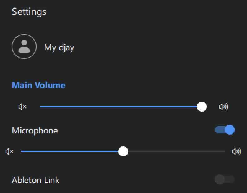

Microphone​
You can connect a microphone and monitor its input level directly in djay Pro. Once your mic is connected, click the microphone icon in the main toolbar to quickly access mic settings.
Microphone settings
Via the microphone settings you can:
  • Toggle the mic on or off
  • Adjust the mic volume
Using a microphone with booth speakers can cause audio feedback. Reduce your booth volume if you experience feedback.
