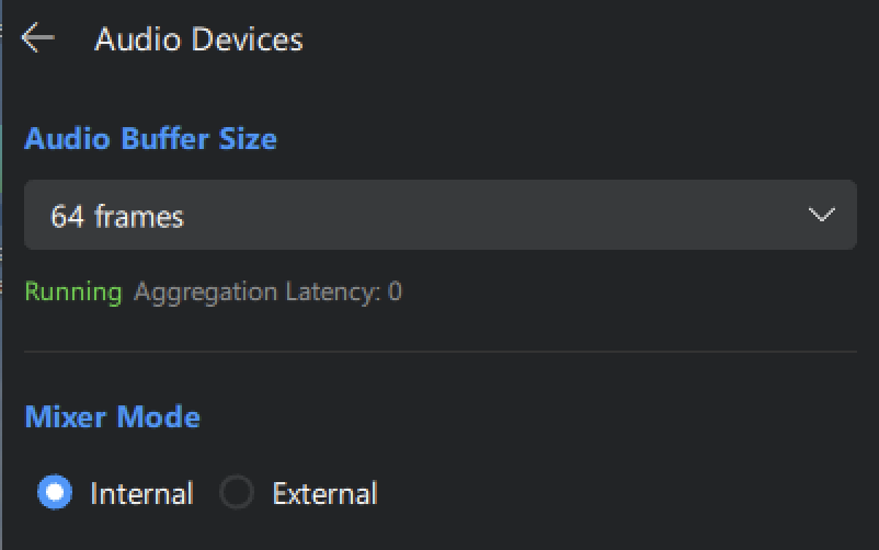

Audio Buffer Size​
The Audio Buffer Size determines how quickly audio is processed by your system:
  • Lower buffer sizes reduce latency and make djay feel more responsive.
  • Higher buffer sizes increase stability, especially on slower systems.
If you hear audio crackling or dropouts, try increasing the buffer size.
Mixer mode​
  • Internal mode: djay's software handles all the audio mixing internally, giving you a single stereo output for your mix. Perfect for mixing inside djay (e.g. on your laptop or with a MIDI controller).
  • External mode: djay routes the audio to separate channels, which can then be mixed by an external hardware mixer. For example, if you connect an external mixer or audio interface.

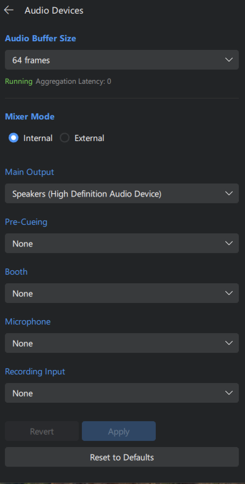

Setting up audio without a controller​
If you’re mixing without a controller, djay Pro lets you route your audio entirely through your device. You can set your main output, enable pre-cueing, and choose your preferred mixer mode directly from the audio settings.
Main output settings
If you’re mixing directly on your laptop:
  1. Go to Settings > Audio Devices.
  2. Make sure you’re set to Internal mixer mode.
  3. Select your Main output (e.g. where you want to hear the sound from. For example, your laptop speakers or external headphones).
  4. Choose whether you want to use Split output for pre-cueing. Remember you need a stereo/mono DJ split cable to make it work properly.
  5. Click apply to save your audio settings.

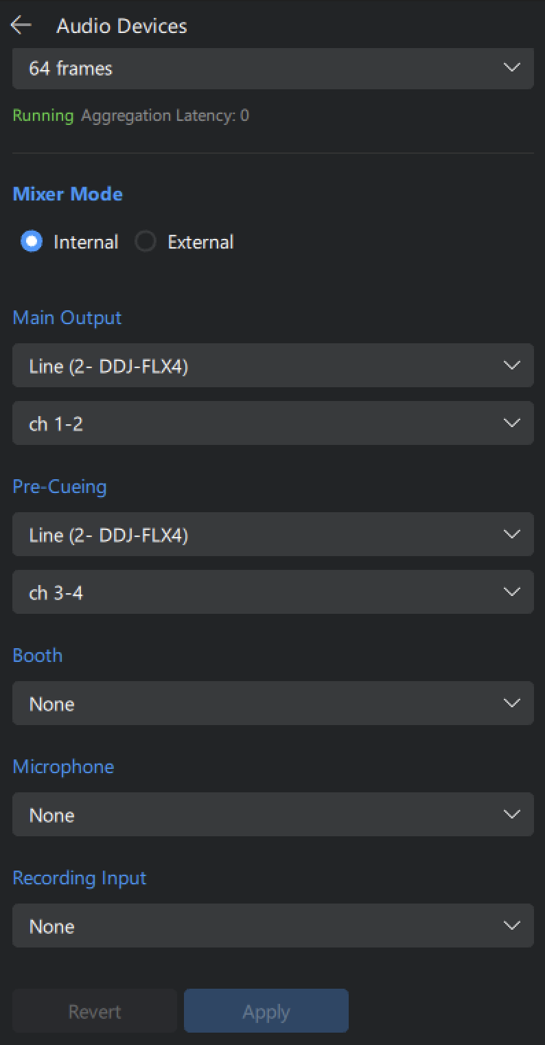

Setting up audio with a supported DJ controller​
When you connect a supported (plug-and-play) DJ controller, djay will automatically configure your audio for you. You can view the full list of officially supported controllers on the Algoriddim DJ Gear page.
Controller audio settings
If you’re mixing with a supported MIDI controller:
  1. Connect your controller via an available port. Turn the controller on using the ON/OFF switch or power button, if needed.
  2. When the controller is detected, follow the on-screen instructions.
  3. djay will automatically detect the controller and configure the audio for you.
  4. You should now be able to control djay Pro using your hardware.
