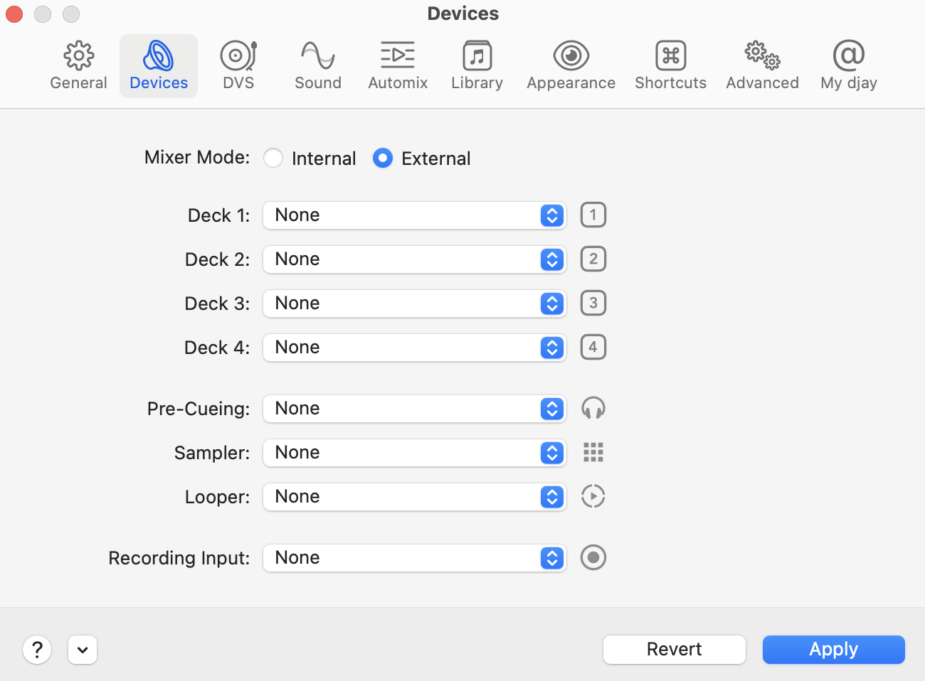

External mixing options​
External mixing device settings
When using an external mixer and multi-channel interface, configure each deck and channel separately:
  • Decks 1–4: Assign stereo outputs for each deck.
  • Pre-cueing: Select the output used for headphone cueing.
  • Sampler: Assign a separate output for the Sampler.
  • Looper: Assign a separate output for the Looper.
  • Recording Input: Choose the input for recording via microphone or external line-in.
To output four decks to a four-channel mixer, you'll need an audio interface with at least four separate stereo outputs. Go to the Connecting hardware section for more on hardware setup.
