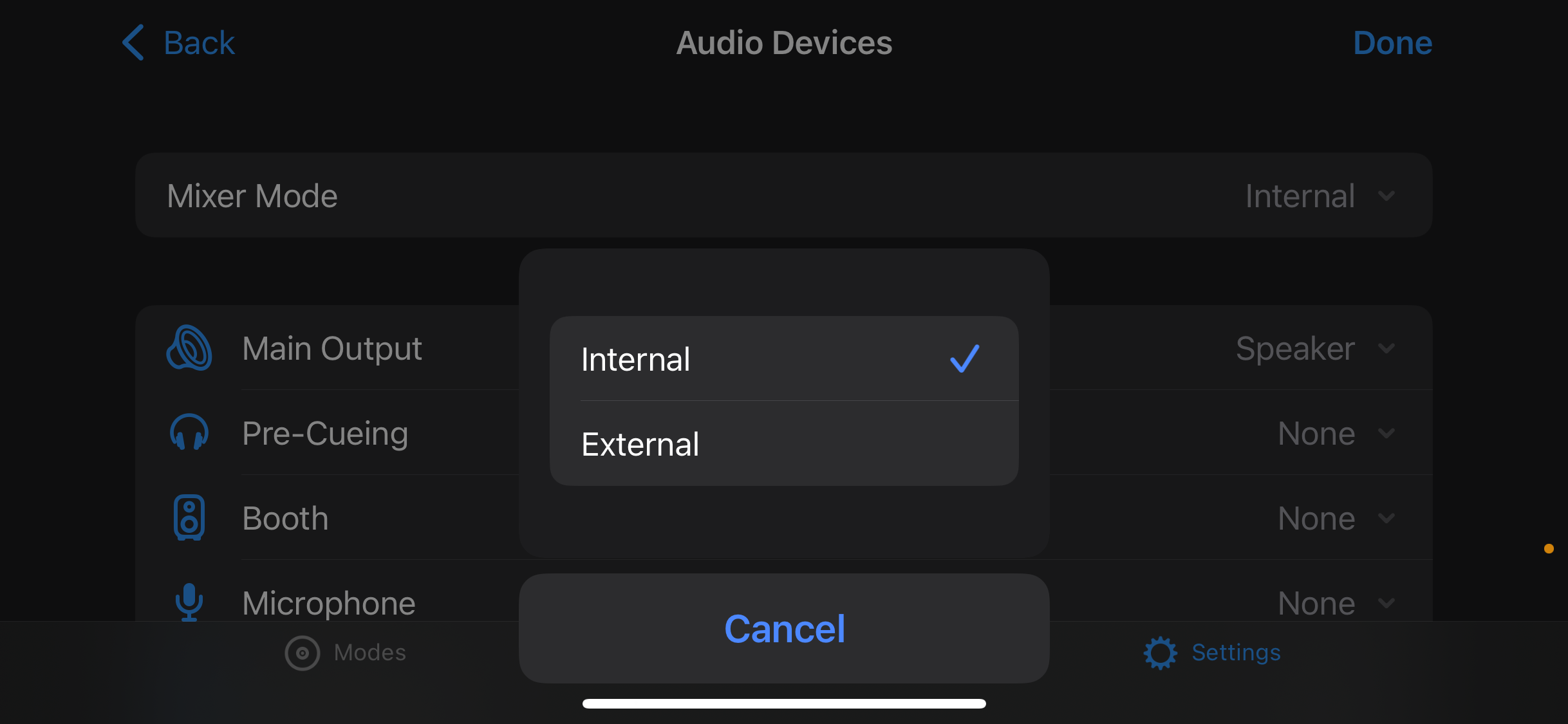

Internal mixer mode​
In Internal mixer mode, djay mixes both decks internally and sends the combined output through the Main Output. You can select up to 4 channels (2 stereo) for your audio interface. Most natively supported controllers function via internal mixer mode by default.
If your controller does not show up automatically in the devices list, you may need to install a driver.
Internal mixer mode
External mixer mode​
Use External mixer mode when your setup includes a separate hardware mixer. Decks, sampler, looper and pre-cue outputs can be assigned to individual audio channels.
In external mode, djay cannot detect the crossfader position, and the internal recording and Automix functions are disabled.
External mixer mode
If you don’t need to use one or more of the available channels, you can also leave them set to None. If you're using a mixer with Pre-Cueing output, you won't need to set a channel specifically for it to work properly; this will be done via the mixer.

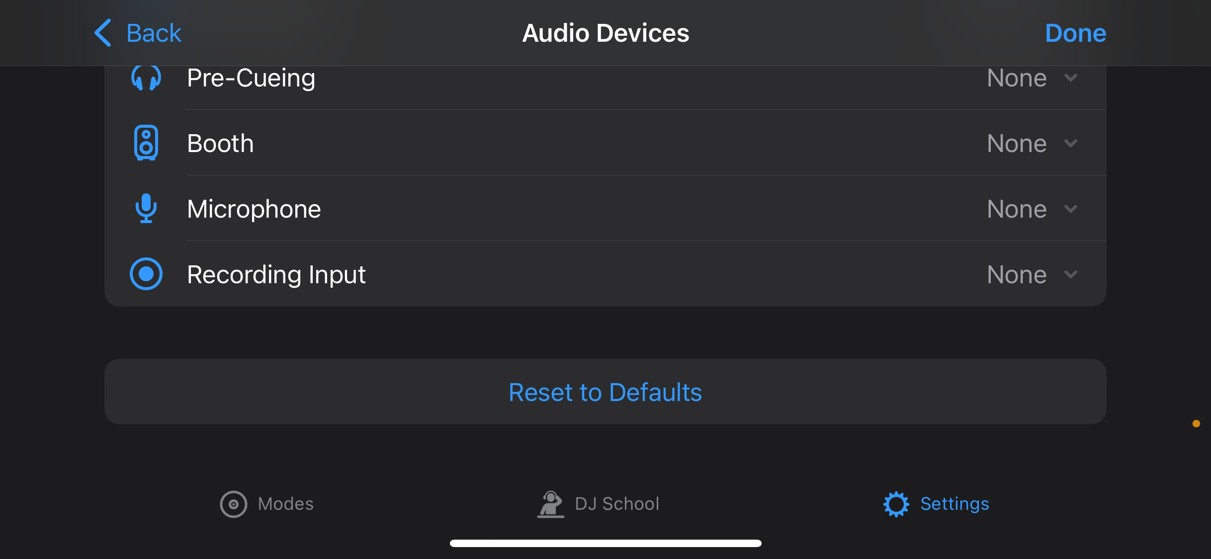

Resetting audio settings​
If you experience issues with audio routing or the output isn’t working as expected, try selecting Reset to Defaults in the Devices settings. This option restores the default audio configuration for your connected hardware, which often resolves common setup issues.
Reset to defaults
