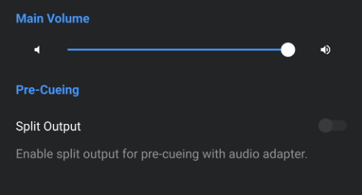

Audio is configured automatically on Android. In Settings, you’ll find the following audio options:
  • Main Volume
  • Split Output (for pre-cueing)
You can also enable Split Output if you want to pre-cue using an audio adapter.
Configuring audio settings
All other audio routing is determined by your device hardware or by any connected DJ controller or audio interface.
