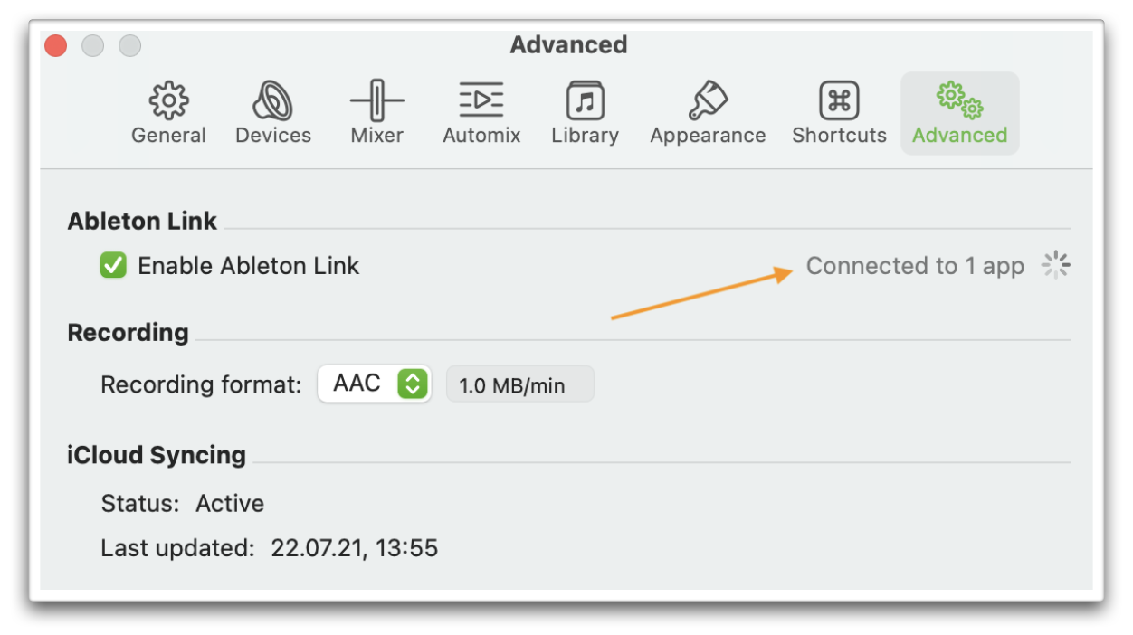

Enabling Ableton Link
To enable Ableton Link in djay Pro AI for Mac, follow these steps:
- Make sure all devices you want to link are connected to the same local WIFI network.
- Open the djay Settings (press ⌘ + ,) and go to "Advanced".
- Select "Enable Ableton Link".
- A beat indicator will appear in djay's User Interface to show you that Ableton Link is enabled and what Master Tempo it is using at the moment.
- When you link another device (or devices), you will see the number of connected devices in the Advanced settings in djay.
Now Ableton Link is ready and you can mix with your devices in sync. For additional information, please see the Ableton Link website.
