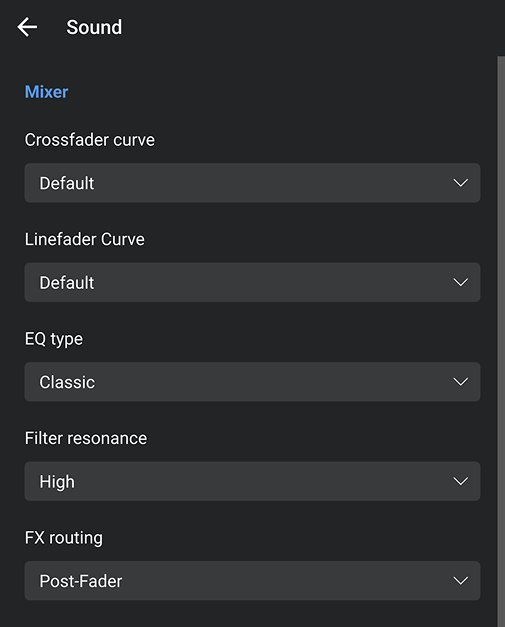

Mixer​
  • Crossfader curve: Decide how the crossfader fades between tracks. Choose between Default, Linear, Constant Power, Dipped, and Cut.
  • EQ Type: Choose between Classic and Isolator EQ controls.
    • Classic EQ: The high/mid/low classic EQ controls are set to a range of -24dB to +6dB at 3,300Hz/1,000Hz/264Hz—similar to a standard club mixer. The range means there is no full kill of audio. If all three are set to 0, some sound will still be heard at lower volume.
    • Isolator EQ: The high/mid/low Isolator EQ controls offer full kill to +6dB at 275Hz / 275Hz–5000Hz / 5000Hz+. This means turning the bass EQ all the way down will completely cut those frequencies from the mix.
You can use the isolator mode to sculpt the sound by completely eliminating frequencies.
  • Neural Mix™ EQ: In Neural Mix EQ mode, choose between two stem layouts for the EQ knobs—Drums/Harmonic/Vocals or Drums/Bass/Melodic.
  • Filter resonance: Switch between Low/Medium/High filter resonance. Lower resonance sounds smoother, and higher resonance adds character to the filter’s sound.
  • FX routing: controls how effects behave with the channel fader:
    • Pre-fader: effects stay active even if you lower the channel fader.
    • Post-fader: effects fade out naturally with the track as you move the fader.
Use post-fader for smooth echoes and reverbs during transitions, and pre-fader when you want to layer creative effects over muted or lowered channels.

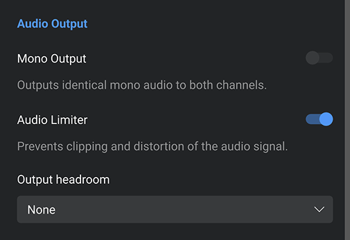

Audio output​
  • Mono output: Sends identical mono audio to both the left and right channels.
  • Audio limiter: Stops clipping and distortion of the audio signal.
  • Output headroom: Reduces the volume headroom of the main output by 0 (disabled), -6dB, -9dB, -12dB, or -24dB.
