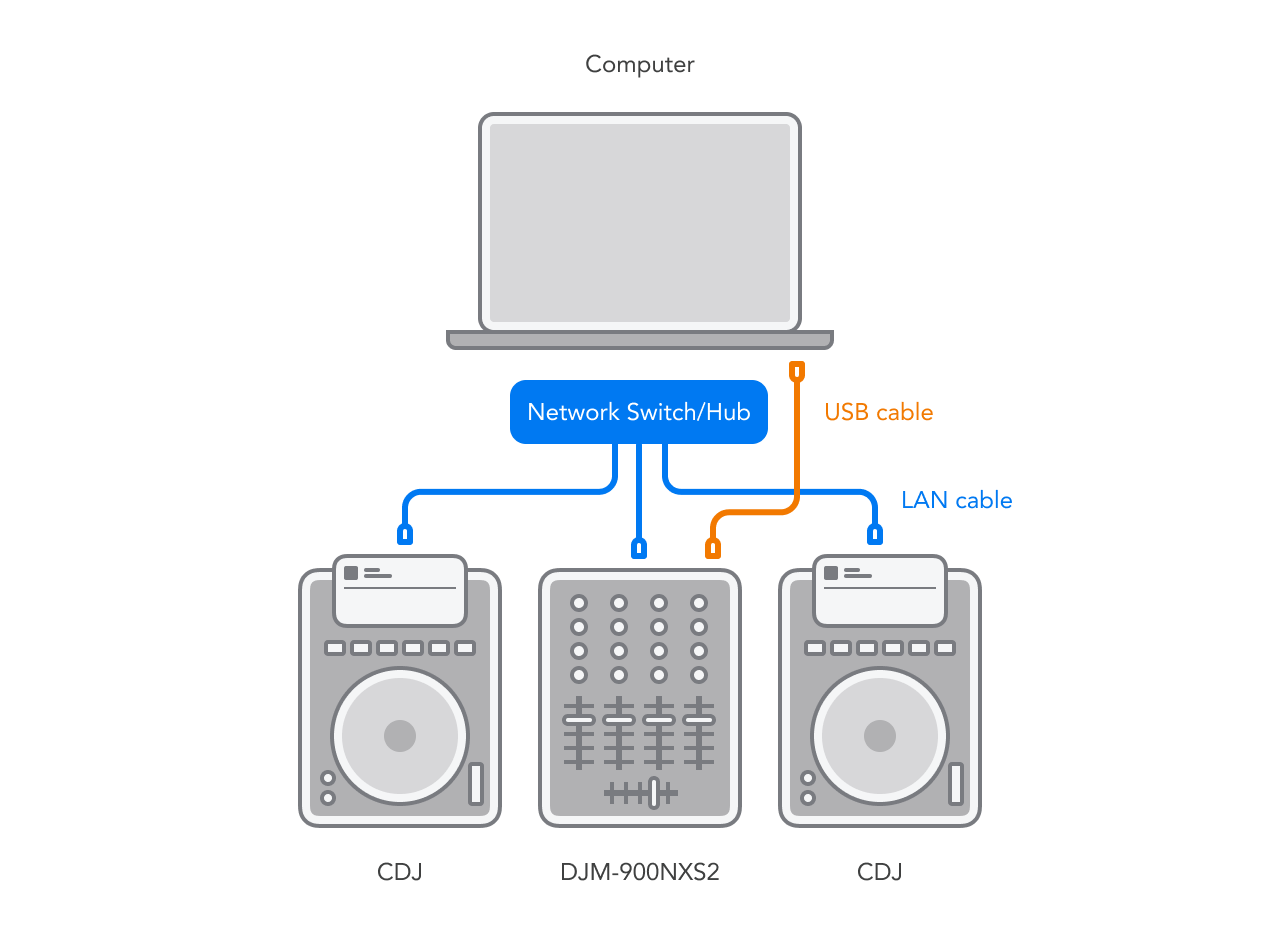

Connecting CDJs using PRO DJ LINK
PRO DJ LINK by PioneerDJ allows you to connect all your devices via Ethernet.
Check the operating instructions of connected equipment for more details about PRO DJ LINK. You can download the operating instructions from the AlphaTheta Help Center.
- Connect CDJs to one of the supported mixers with PRO DJ LINK through LAN using a switch.
- Connect the mixer to your computer with one USB cable.
- Once the connections have been made, turn on the power of all the units. Then, follow the instructions below to set up each player.

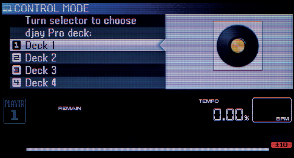

CDJ-3000
Select [CONTROL MODE (CDJ)]. Press the rotary selector to fix it. The player is now recognized by djay Pro.
CDJ-2000NXS2
Press the [LINK] button on the player and select [USB MIDI] for the [CONTROL MODE]. Press the rotary selector to fix it. The player is now recognized by djay Pro.
Lastly, set each deck on the CDJs. Turn the rotary selector to select the deck to control (1 to 4). Press the rotary selector to fix it. The player can now control the selected deck on djay Pro.
