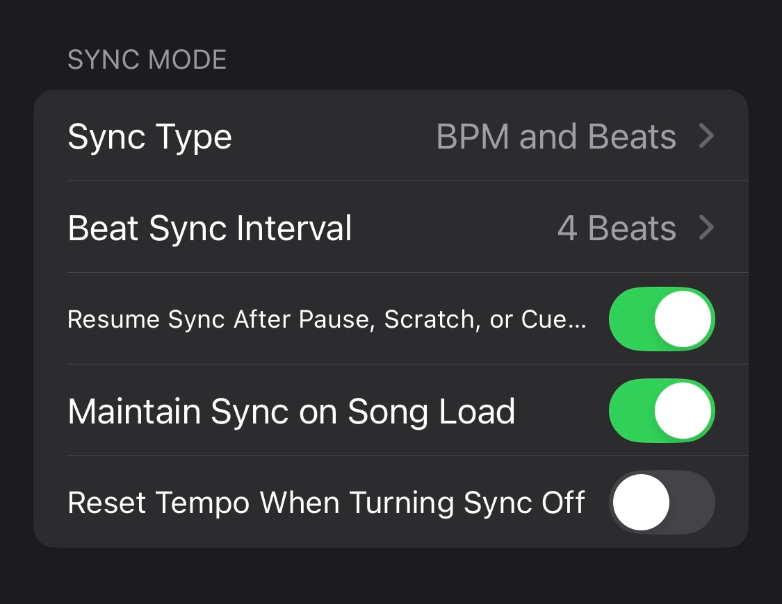

To choose your preferred sync mode, go to Settings > General > Sync Mode > Sync Type.
Sync mode settings
BPM sync
BPM sync only matches the tempo (BPM) of a track to the current main deck. The tracks will play at the same speed, but their beats are not locked together—allowing you to nudge or beat-match manually.
  • To sync a track’s BPM, press the Sync button on the deck you want to match.
  • The Sync button label will turn blue when activated.
